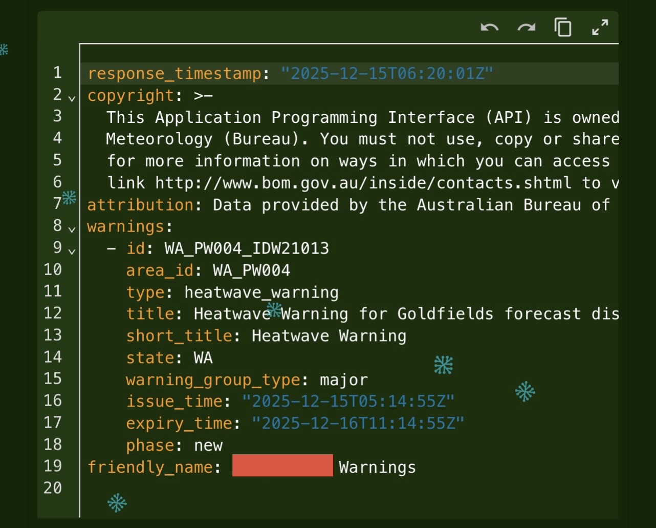

So when there’s an active warning it’s displayed like this…
And I want to display the short_title or title attribute in this integration

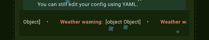

But all that is displayed is “weather warnings: [ object object ]”
Any suggestions would be greatly appreciated!
This is how it’s displayed
You’re going to need to use the value_template option.
type: custom:strip-card
duration: 40
transparent: true
show_icon: false
continuous_scroll: true
border_radius: 12px
card_width: 100%
entities:
- entity: sensor.REDACTED_warnings
value_template: |
{{ states['sensor.REDACTED_warnings'].attributes.warnings[0].short_title }}
value_color: "#f0f000"
name_color: "#f2761d"
Whatever version of “Jinja2 templates” they are using in the card does not seem to support filters like map or using loops, so there doesn’t seem to be a good way to get multiple warnings if they exist. If that is something you want, you may need to handle that in a Template sensor
