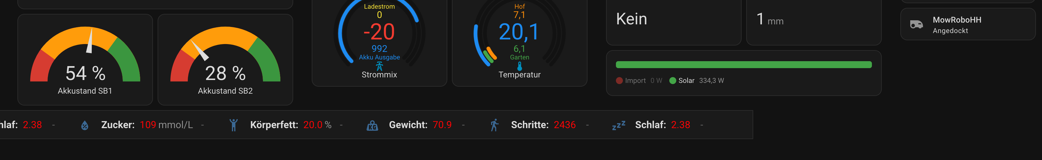

Wow, this is great! But f or some unclear reasons I can’t make it fill the entire with (see screenshot). Any idea how to fix this?

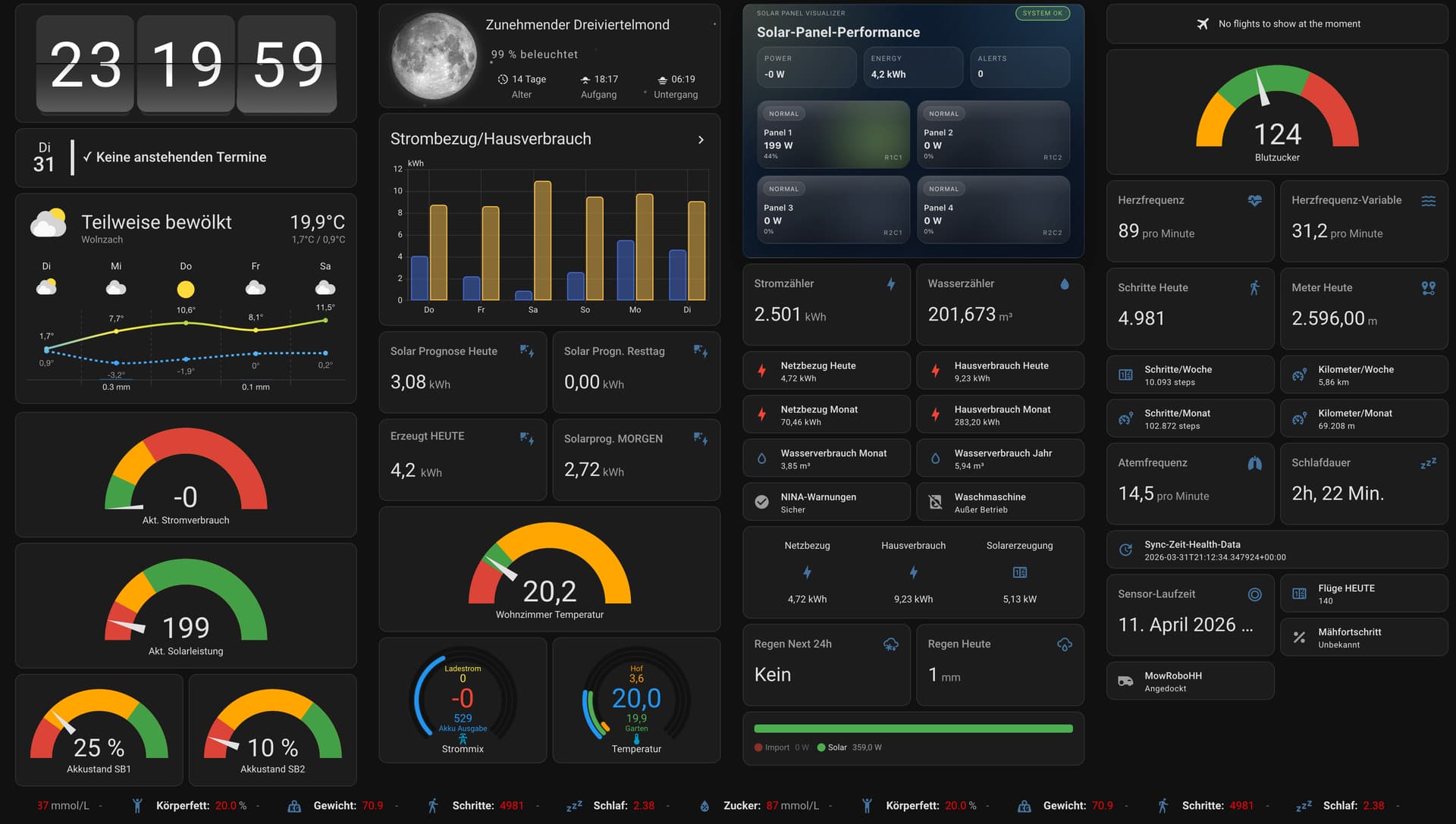

Sorry, I knew instantly that I forgot some basic information here… This is my “standard” dashboard, running on a 16 inch Acer P16 tablet. You see the ticker on the button - it doesn’t fill the entire screen no matter how wide I set it. See yaml-part below the screenhot (I hope the code is entered in the right way here).
EDIT: just found the reason - the card should not be placed in the first column. Moved it to the right and there we go with the full with ticker! Yet again thank you very much for this useful card!

Thank you for the update! I still have the issue to get the full with in my four columns dashboard, no matter what I do. I’ve shifted it between column two and three - in two it has a blank area on the right, in column three it has the blank part on the left (see screenshot). Can’t see any issue in the YAML. As stated above the issue is available in the browser (current Firefox) as well as in Fully Kiosk on the Acer P16 Tablet I am using for the dashboard. Can you check where I am wrong? Any help is welcome!

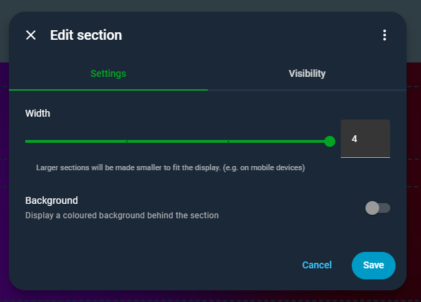

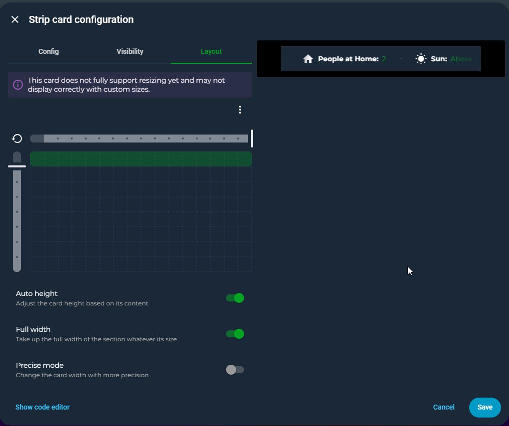

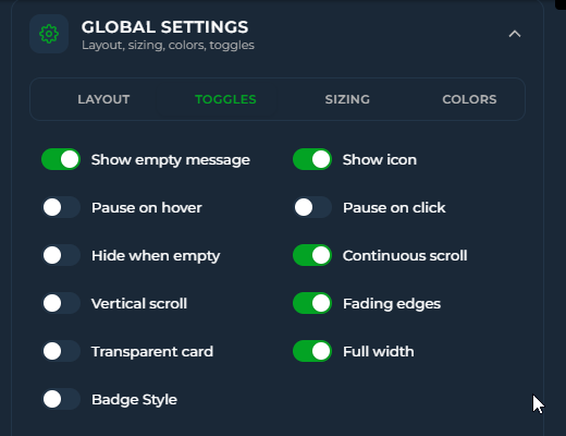

@luha68 I am not sure If I could reproduce the same issue on my dashboard but I managed to card width to full screen with step below
Go to section options and make width highest
Go to Layout tab and toggle Full Width option to true
Then go to card options to Toggles tab and toggle on Full Width
Result

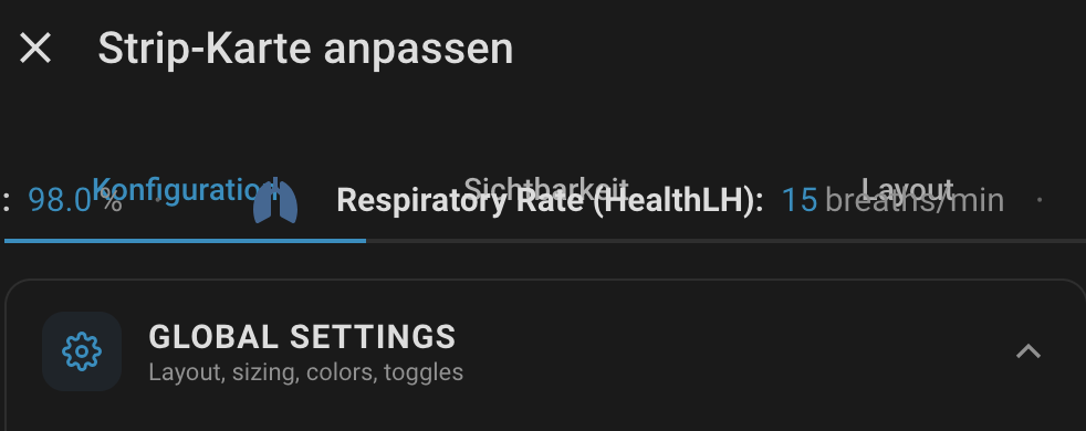

Okay, okay, okay - that Layout tab setting did the trick. I think I know why I didn’t see it: when in config the preview is running over that tab:

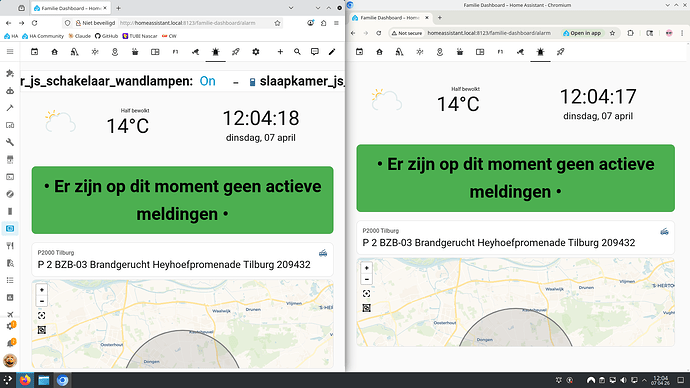

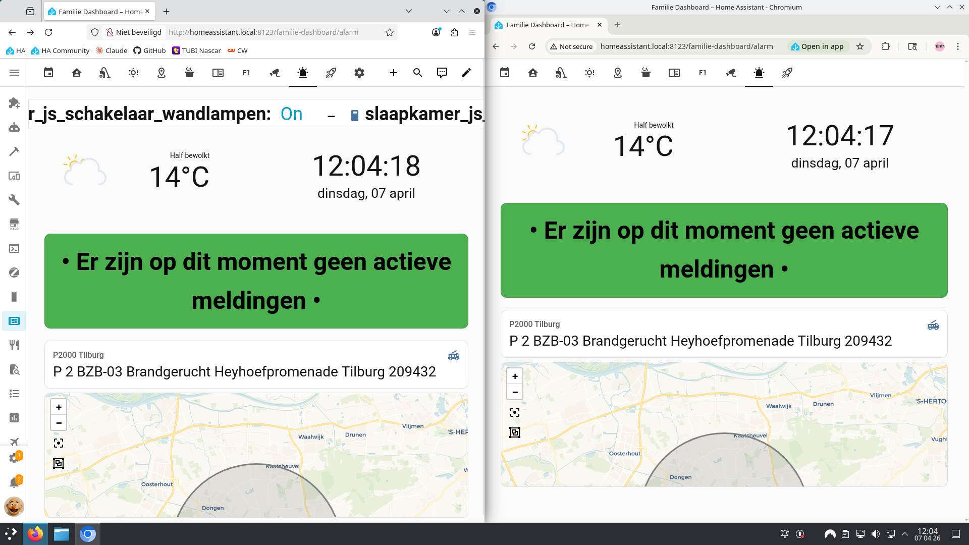

@cataseven any idea what can cause the ticker to stay empty on chromium?
I see the card & background color (full width) my best guess is that the browser misses something to render it.
Tested it on 2 debian systems, the rest of the dashboard cards work fine.
Also the ticker works and is active when I use firefox and also when I use chrome on win11. So it should be browser related.

Hi @Johan_L
Can you please share yaml code and a screenshot?
Johan_L
(Johan)
April 7, 2026, 10:10am
20
@cataseven it took a few days but here is the screenshot and yaml.
Strange thing is that it’s only on chromium.
