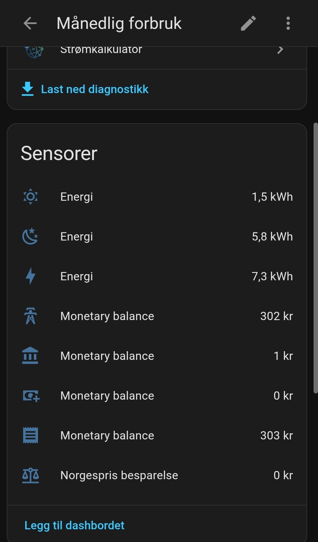

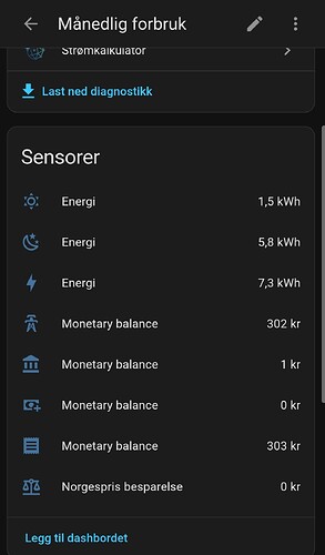

This is great. I just have an issue that alot of the sensors are just called “Monetary Balance” and its hard to understand what is what.

I hadn’t tried it properly in English myself as my HA is set to Norwegian. I fixed all the names with the version just released.

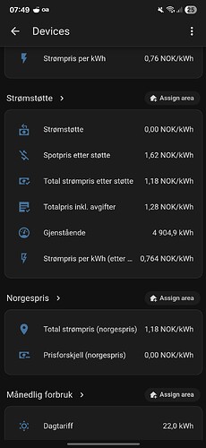

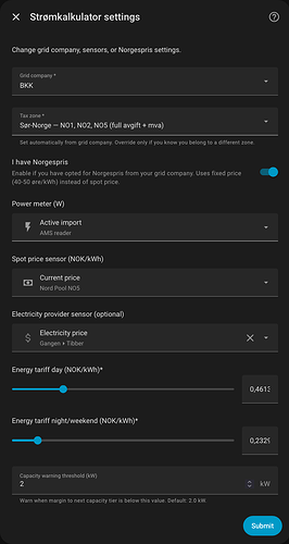

Thanks. There are a few more quirks. When selecting norgespris, your inegration stops calculating strømstøtte, and therefor the possibility to compare the two goes away
As you can see in my screenshot “strømstøtte” shows 0, “spotpris etter støtte” just shows the spotprice, “total strømpris etter støtte” shows, as far as i can tell norgespris+gridTariff+estimated capacity cost.
Well, you can see the rest.
Edit: all in all I find the names/numbers a bit confusing. It’s hard to get a grasp of what they actually represent.
I have a release fixing that soon.

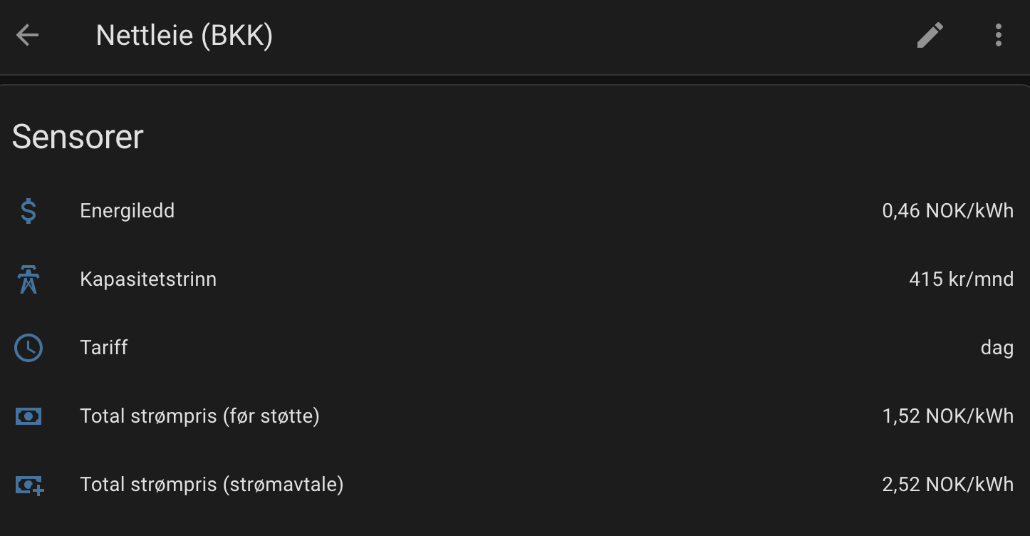

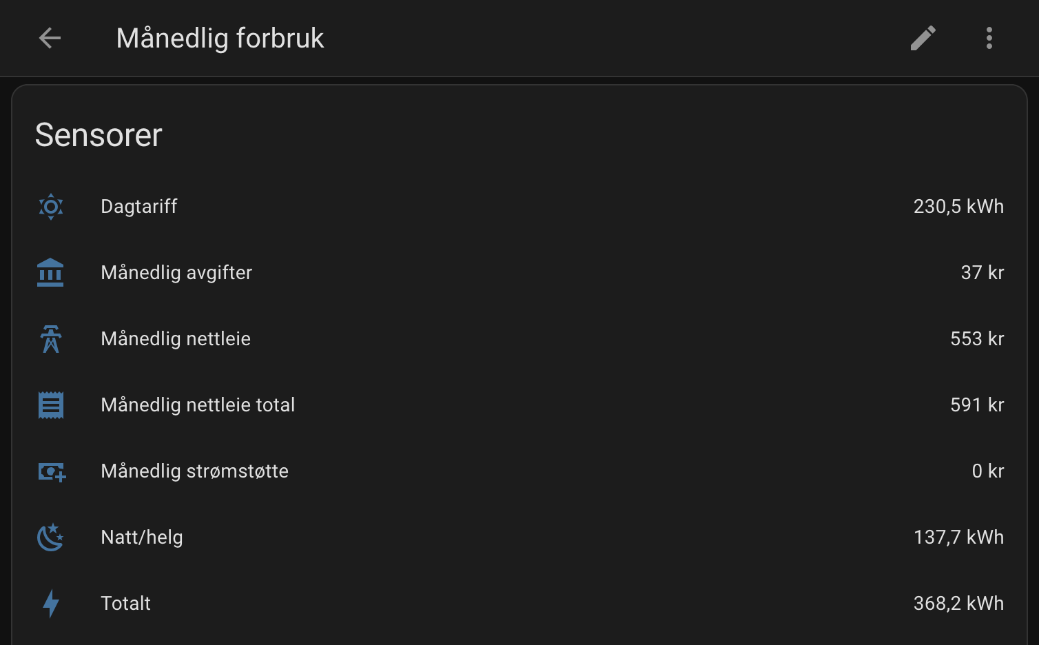

For BKK:
Is the Norgespris + grid-tarriff wrong?
(Valid from 1.1.2026: day: 46.13øre/kwh)
This should be 50 (norgespris) + 46.13 = 96.13, right?
What specific stuff are you missing? I can add some disabled sensors that you can enable. I already have too many so a few more wont hurt :crazy_face: (30 enabled + 12 disabled by default)
Maybe I’m misunderstanding your question, but the 1.18 NOK/kWh is correct. “Total strømpris (Norgespris)” includes three components:
  1. Norgespris: 50 øre/kWh
  2. Energiledd (grid tariff): 46.13 øre/kWh (day rate for BKK)
  3. Kapasitetsledd (capacity charge): spread per kWh
BKK charges a monthly capacity fee based on your peak power usage (e.g. 155 kr/mnd for 0-2 kW, 250 kr/mnd for 2-5 kW). The sensor divides this across all hours in the month. With the 0-2 kW tier: 0.50 + 0.4613 + (155 / 30 / 24) = 1.18 NOK/kWh.
The attributes on the sensor show the breakdown (norgespris, energiledd, kapasitetsledd_per_kwh) so you can verify each part.

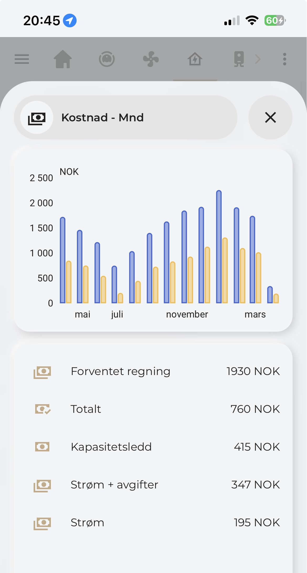

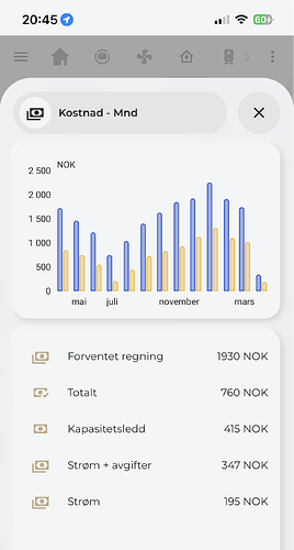

Ahh that’s the reason then, I always add the Kapasitetsledd as a lump-sum instead of thinking of it as an extra ‘fee’ on the kwh price, but then I know the reasoning for that :slight_smile: thanks!
Quite a few of the sensors in this integration is going to replace a few of the one I already have, but i think I prefer a ‘clean’ ‘raw’ price
Nice setup. You’re already doing what my “Månedlig total” sensor does: kapasitetsledd as a lump sum, not spread per kWh.
Here’s what maps to your current sensors:
Your sensor Strømkalkulator equivalent
Strøm Strømpris per kWh (spot + energiledd, no kapasitetsledd)
Strøm + avgifter Månedlig nettleie total (energiledd + kapasitetsledd + avgifter)
Kapasitetsledd Kapasitetstrinn (shows kr/mnd directly)
Totalt Månedlig total (nettleie complete)
Forventet regning Estimert månedskostnad (linear projection)
Coming soon: an accumulated cost sensor (stat_cost mode) that tracks total cost including kapasitetsledd as a time-based increment instead of per-kWh. That one gives the Energy Dashboard a correct monthly total without the kapasitetsledd spreading issue.

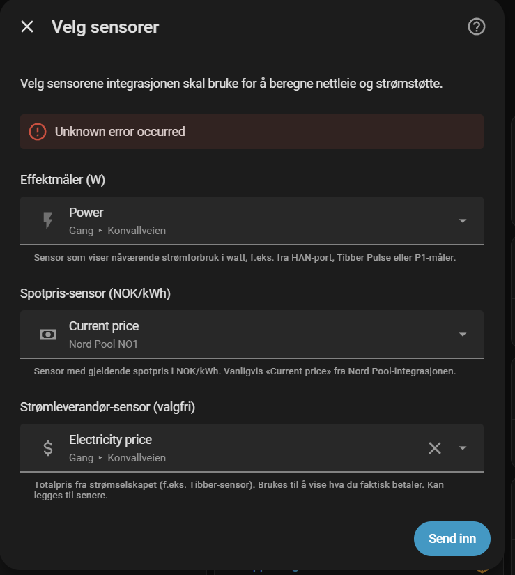

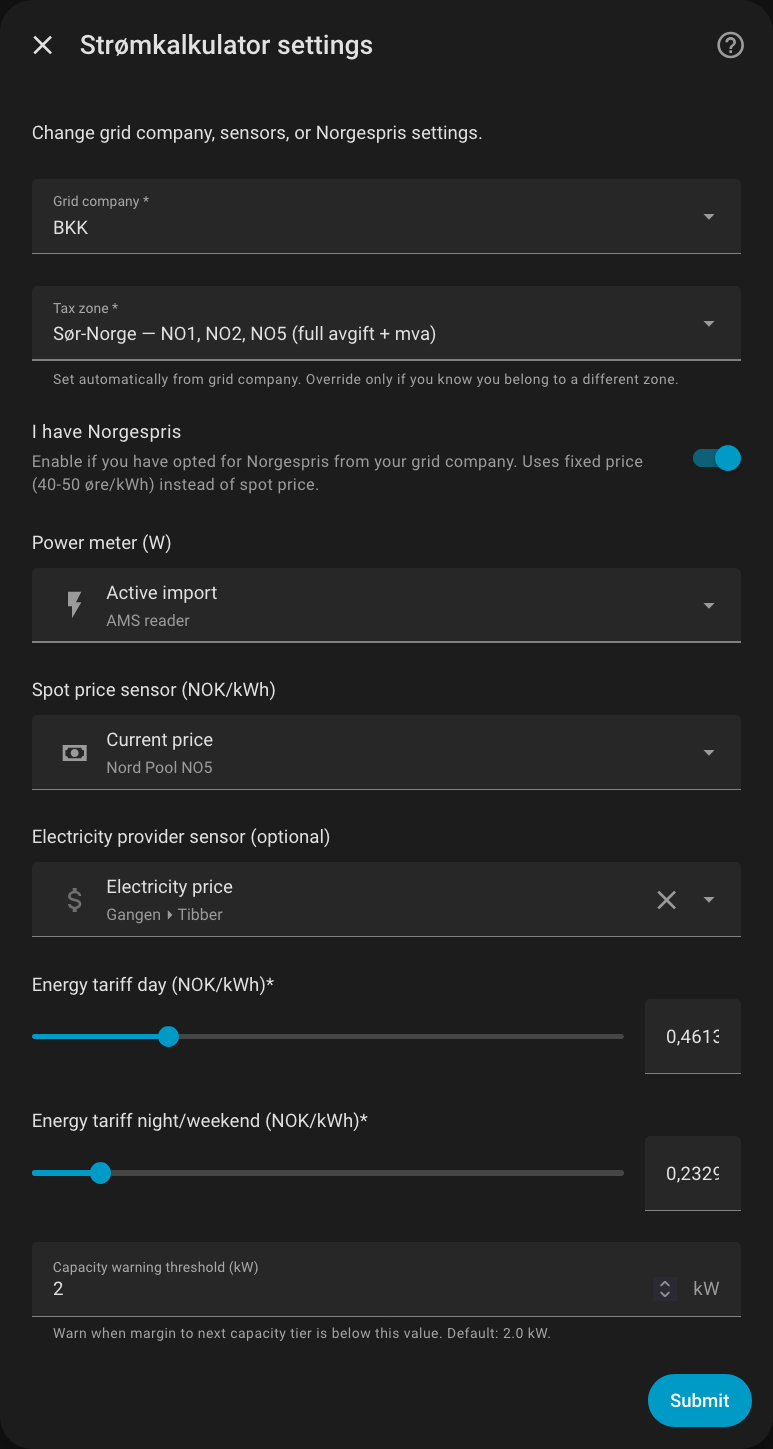

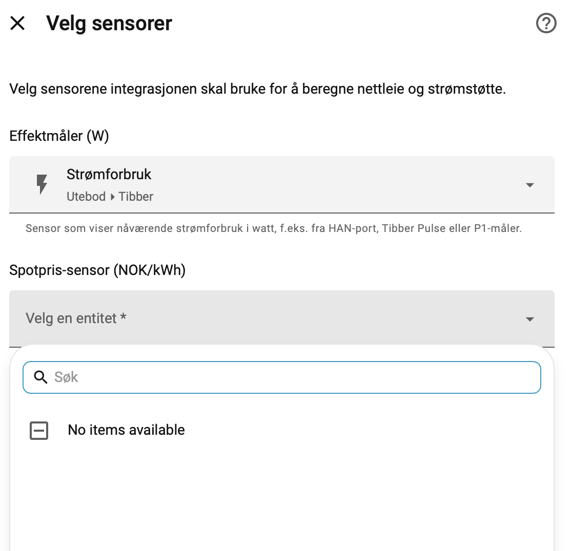

Hei, jeg får ikke til dette. Jeg får ikke opp noe på “Spotpris-sensor (NOK/kWh)”. Så det stopper der hos meg. Jeg har nordpool installert. Hva gjør jeg feil?
Takk for svar
Det var jeg som la på filter device_class: monetary, men Nordpool-integrasjonen setter ikke denne device-klassen på sine sensorer. Resultatet var “No items available” i dropdown-en, selv om Nordpool var installert og fungerte. Fikset det nå
