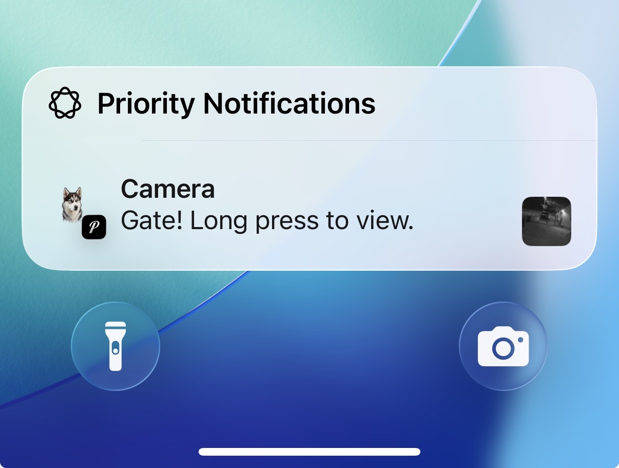

My apologies for reopening this topic folks. It kept coming up in my searches and I was hoping I could add some context here for folks that are really struggling with this. I’ve just notated what worked for me.
I have an exterior camera that takes a snapshot and I save it here /config/www/gate.jpeg Then Pushover sends a push to my device with the image. In it I specified. /config/www/gate.jpeg which works. Any other location I tried never worked. I tired many variations but the above is what yielded success.
If you wish to specific the HA companion app you can use /local/gate.jpeg which I used previously.
Notes:
  1. I am using the HACS version of the Pushover which supports TTL.
