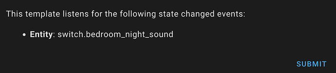

But when I do, I get the message that HomeAssistant is only listening for switch.bedroom_night_sound changed events and the state does not update.

Is there a way to ensure the value is tracking both switches?
true is not “on”
The template editor only says it’s listening to one entity because the first clause of your and always fails… false is also no “on”. It doesn’t need to listen to the other entity until the first clause passes.

This syntax still gives the following note:
The goal is that the template switch only reports ON if both conditions are true: night sound is ON, subwoofer is OFF.
