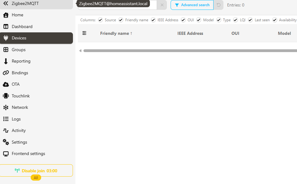

I am trying to pair a device and it cannot be seen: TRVs
I’ve checked the radio traffic on my network and decided to use channel 25 instead of 11.
So you followed this guide then???
You said you were being told the OS was installed wrong, now you are showing us a screen grab of zigbee2mqtt which is an addon not the OS. I think it may be an idea to read the docs from the start to understand how HA works.
