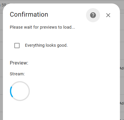

But when I try that in Generic Camera, it spins and never shows the video stream.

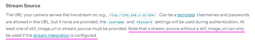

I did not configure a still image url, I don’t think it is required.
I feel like I am really close to success but it is still eluding me.
https://www.home-assistant.io/integrations/generic/
