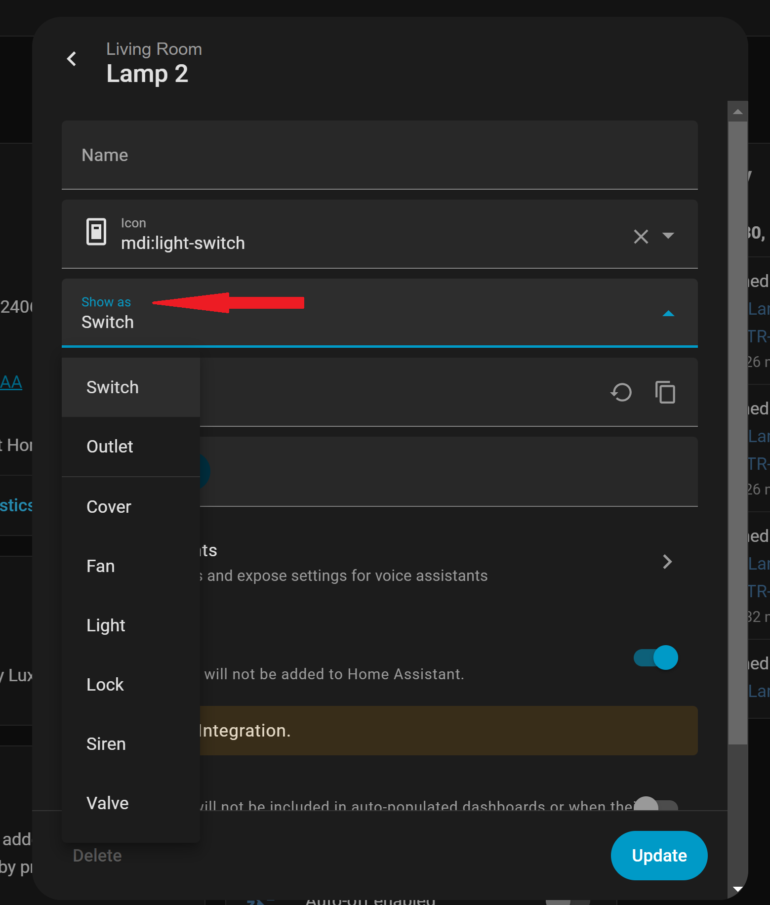

The only way I know of to have a switch show up as a light.your_switch_as_a_light is in the switch settings using the ‘Show as’ option. This creates the light entity and hides the original switch (still shows in Device settings and can be used, just hidden from auto generated dashboards).
Maybe check each of these switches device pages to see if you have the light entity and check the switches settings.

Third item down in the switch settings…

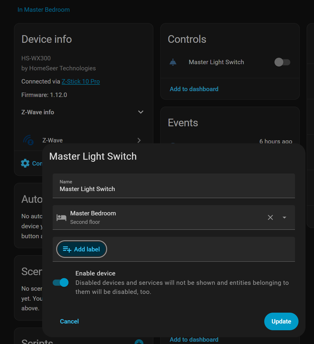

I don’t seem to have that option. Should I be looking somewhere else?
What are you clicking on to get that? There’s not even an entity_id in that pic.
In your screenshot you should be clicking on ‘Master Light Switch’ in the ‘Controls’ section, then clicking on the cog in the upper right hand corner to open up its settings.
