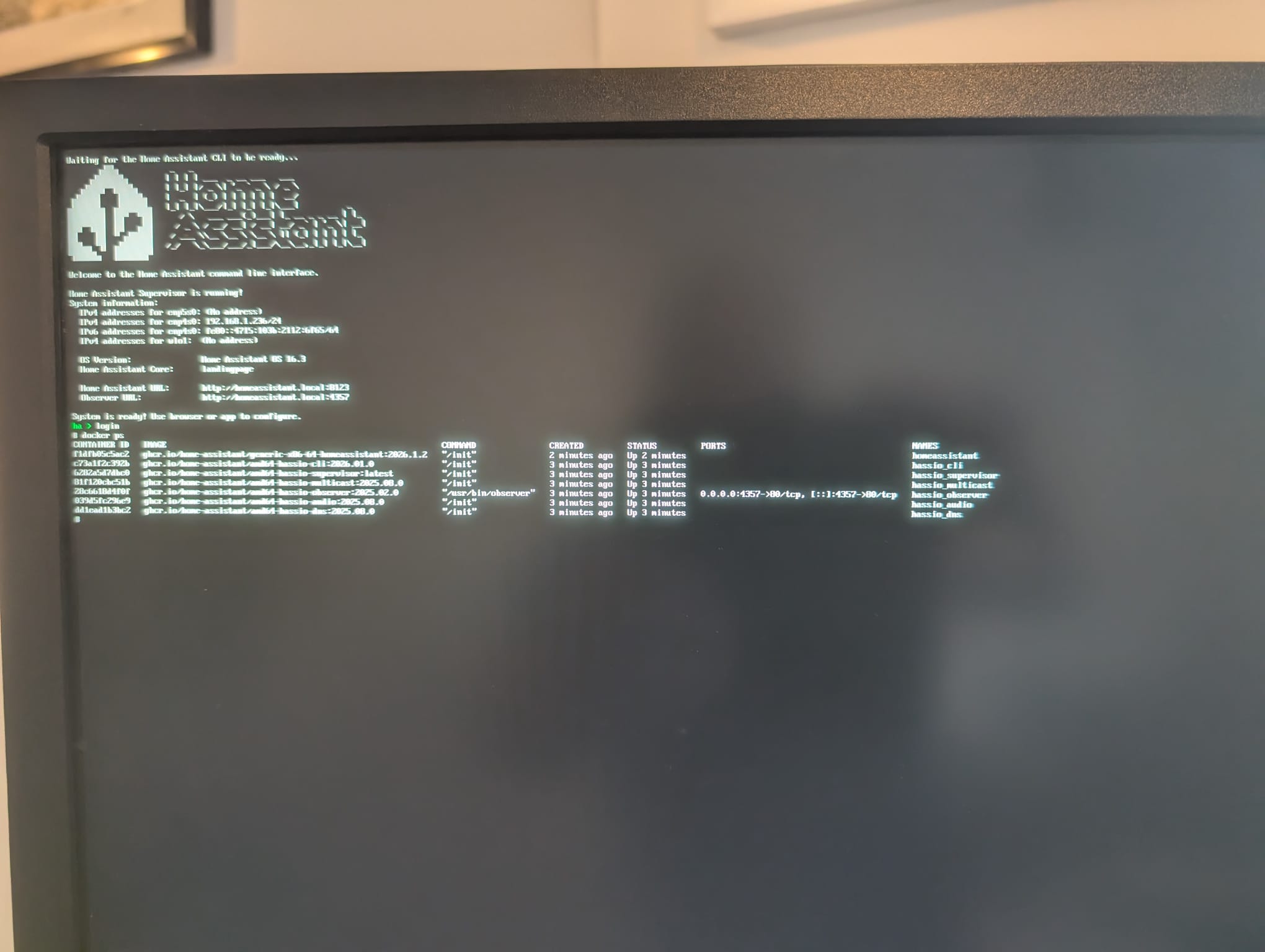

I installed the generic x86 image on the NUC without issue and the machine starts up without issue, however i can’t access it on the web interface.
homeassistant.local resolves fine, I’ve also tried the ipaddress of the machine with no luck.
i can ping the machine, there are no firewalls or anything else Involved.
i ran nmap and I can’t see any of the ports open on the machine and when I “login” from the cli I can’t see any ports mapped when I do a docker ps
is this normal, have i missed something ?

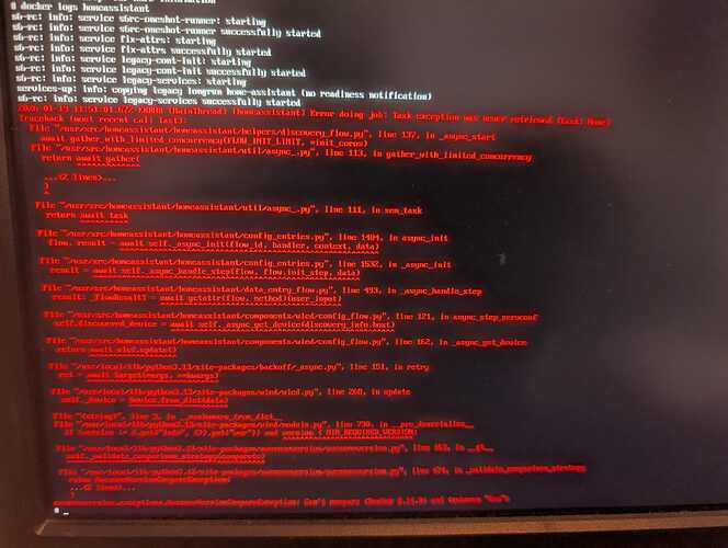

I’ve done a login from the cli and looked at the docker logs - the home assistant container has this…
Uff… a bunch of errors…
i’d start over and follow INSTRUCTIONS . Note that NUC must have internet access in order to complete HA installation.

Your screenshots are almost impossible to read. But it looks like your issue is in the first image that shows you have no IPv4 address. Ehternet only. WiFi is strongly not recommended for the Home Assistant server host computer.
Most Intel NUCS boot device is an M.2 SSD. The easiest way to install Home Assistant on a NUC is to put the SSD into a USB adapter, flash the generic x-86 image to the SSD, reinstall the SSD into the NUC, Done.

sorry about the image, it’s hard to get a clear one with this setup.
it has an ipv4 address (192.168.1.236) on the first ethernet adapter.
I did exactly this, i booted from a USB live ubunto image and imaged the M.2 nvme with HASOS
the think is on the netwoirk but can’t be accessed from the network it’s like the port is not mapped on docerk, I’m keen to run bare metal, i also would rather swerve proxmox etc
