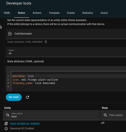

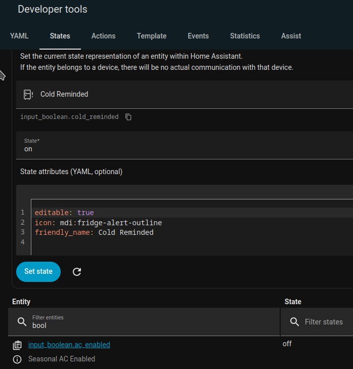

Try
'on'
If you are unsure what the possible states can be, look in
Open your Home Assistant instance and show your state developer tools.
