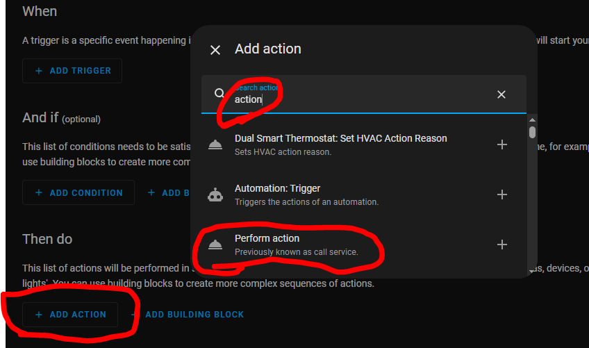

And while you are at it change the actions to … Actions (previously known as service calls).
If you named the phone to say “Wuffls” then when you replace the phone, and you delete the old one and add the new one with the same name, it will just work.
Having it bound to a device id will be lots of work.
The other method some people use is to create a script with the notify phones actions.
That way you can pass the message to the script and run the script.
And when it’s time to replace it, you just change in one place.

Would you mind providing a link to what you mean by “Actions” please? It seems to throw up various vagueries referring to action when I try and search. Eager to learn. I assume this is just trying to keep things more object oriented, which clearly means I’m showing my age with my actionscript flashbacks.
It is indeed a bit all over the place. There is a mention of actions under the automations docs which is basically just an anchor, but then also under the script syntax docs here and here, plus every integration has information on its actions in its docs. Mobile notifications via the companion app are even more special, with its docs under the companion app docs.

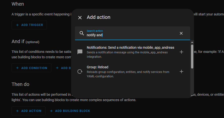

In this case though, just go to the actions page under the dev tools on your HA instance and start to type notify. Select the one you want (each mobile device using the companion app has its own notify action). Then look at the YAML generated.

Using this method:
Means you are not using device.
You can also do this:
just make sure there is no device id in the yaml and your fine.
