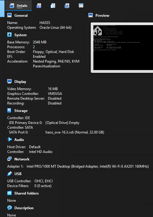

Im downloading HomeAssistant OS via Oracle Virtual Machine
above is my settings
And im stuck at

Bridging over WiFi is not reliable
I have no clue why the docs even use WiFI in the example.
Still, check this in the VM
ha network info
ha supervisor logs
ha core logs

You seem tot have a virtual wired & WiFi adapter.
From the image of the console, it’s not clear but is your virtual wired not connected and does HA not have an IP?

Can you show a clear/enlarged image of that console?
