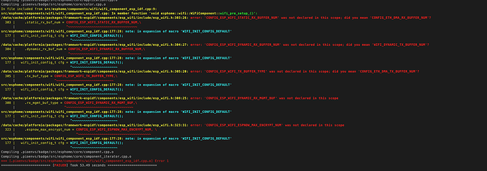

I’m a bit stuck at the moment sadly. I’m trying to compile a firmware for an esp32-p4 via the Homeassistant EspHome Builder addon, although it doesn’t seem to work due to compiler errors (for example /data/cache/platformio/packages/framework-espidf/components/esp_wifi/include/esp_wifi.h:308:25: error: ‘CONFIG_ESP_WIFI_DYNAMIC_RX_MGMT_BUF’ was not declared in this scope)
I’m not sure where to start really, maybe someone can give me a hint where to start looking / configuring stuff?

In file included from src/esphome/components/wifi/wifi_component_esp_idf.cpp:9:
src/esphome/components/wifi/wifi_component_esp_idf.cpp: In member function 'void esphome::wifi::WiFiComponent::wifi_pre_setup_()':
/data/cache/platformio/packages/framework-espidf/components/esp_wifi/include/esp_wifi.h:303:26: error: 'CONFIG_ESP_WIFI_STATIC_RX_BUFFER_NUM' was not declared in this scope; did you mean 'CONFIG_ETH_DMA_RX_BUFFER_NUM'?
  303 |     .static_rx_buf_num = CONFIG_ESP_WIFI_STATIC_RX_BUFFER_NUM,\
src/esphome/components/wifi/wifi_component_esp_idf.cpp:177:28: note: in expansion of macro 'WIFI_INIT_CONFIG_DEFAULT'
  177 |   wifi_init_config_t cfg = WIFI_INIT_CONFIG_DEFAULT();
/data/cache/platformio/packages/framework-espidf/components/esp_wifi/include/esp_wifi.h:304:27: error: 'CONFIG_ESP_WIFI_DYNAMIC_RX_BUFFER_NUM' was not declared in this scope; did you mean 'WIFI_DYNAMIC_TX_BUFFER_NUM'?
  304 |     .dynamic_rx_buf_num = CONFIG_ESP_WIFI_DYNAMIC_RX_BUFFER_NUM,\
/data/cache/platformio/packages/framework-espidf/components/esp_wifi/include/esp_wifi.h:305:20: error: 'CONFIG_ESP_WIFI_TX_BUFFER_TYPE' was not declared in this scope; did you mean 'CONFIG_ETH_DMA_TX_BUFFER_NUM'?
  305 |     .tx_buf_type = CONFIG_ESP_WIFI_TX_BUFFER_TYPE,\
/data/cache/platformio/packages/framework-espidf/components/esp_wifi/include/esp_wifi.h:308:25: error: 'CONFIG_ESP_WIFI_DYNAMIC_RX_MGMT_BUF' was not declared in this scope
  308 |     .rx_mgmt_buf_type = CONFIG_ESP_WIFI_DYNAMIC_RX_MGMT_BUF,\
/data/cache/platformio/packages/framework-espidf/components/esp_wifi/include/esp_wifi.h:323:31: error: 'CONFIG_ESP_WIFI_ESPNOW_MAX_ENCRYPT_NUM' was not declared in this scope
  323 |     .espnow_max_encrypt_num = CONFIG_ESP_WIFI_ESPNOW_MAX_ENCRYPT_NUM, \
Compiling .pioenvs/badge/src/esphome/core/component.cpp.o
Compiling .pioenvs/badge/src/esphome/core/component_iterator.cpp.o
*** [.pioenvs/badge/src/esphome/components/wifi/wifi_component_esp_idf.cpp.o] Error 1
========================= [FAILED] Took 53.49 seconds =========================
If you come across compile errors always the first thing to do is clean the build files 3 dots on the right in the drop down somewhere. This may or may not work. Someone with more knowledge may be able to help more.
ESP32-P4 don’t have WiFi. So…
While P4 might be able to run esphome code, it’s not anyhow usable for normal HA setups because it doesn’t have any radio. Of course it could be connected to some module that has wireless capabilities.
TMHO Esphome documentation should mention this…
No P4 has native WiFi at this time, but most boards come with a second chip that does, you have to configure it.
