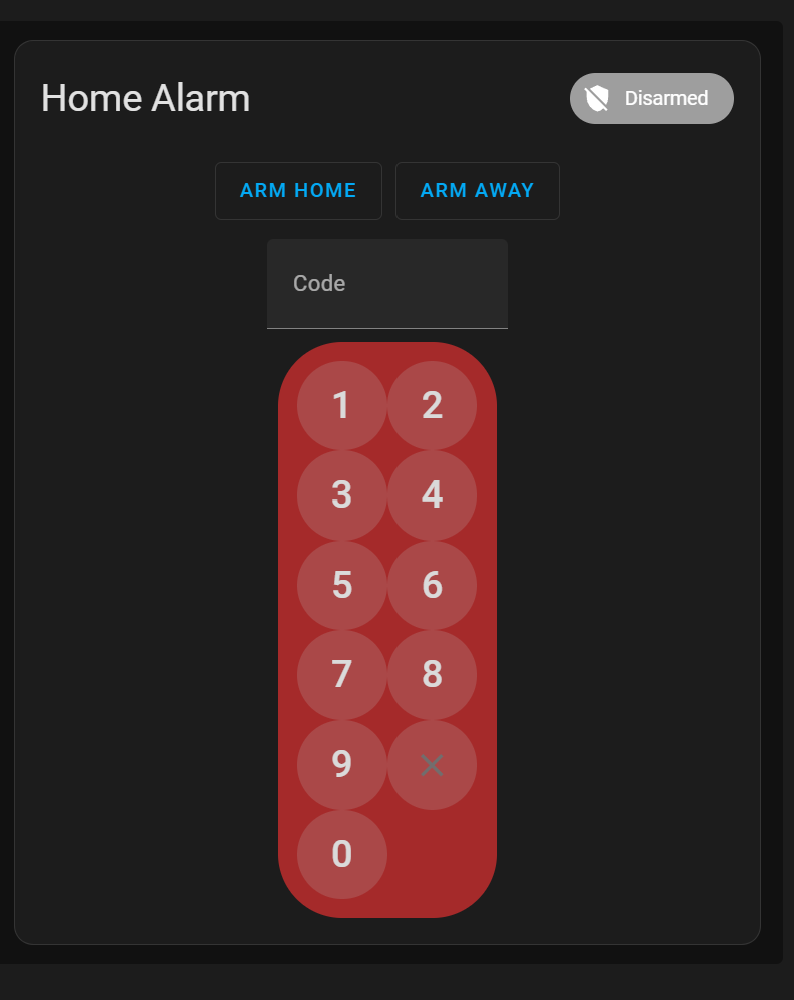

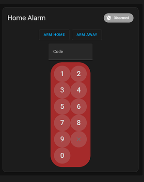

Quick test…
Can you share the code please ?
thx

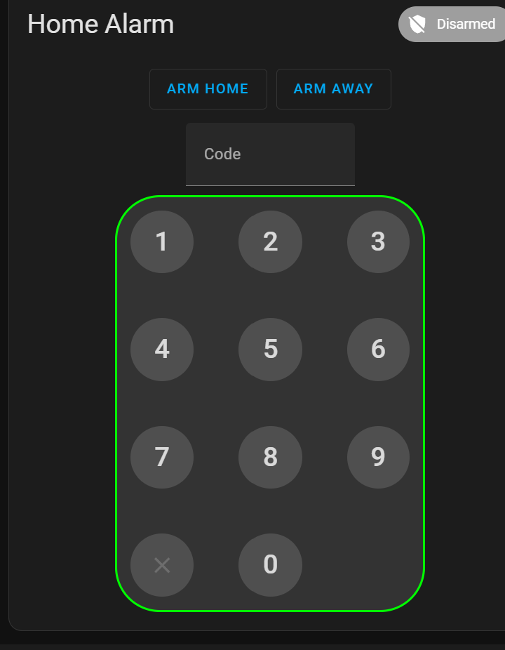

What portion are you trying to mod?
card_mod:
 style: |
  .keypad {
    gap: 40px !important;
    background: #333333;
    border: 2px solid lime;
    border-radius: 40px;
thx !

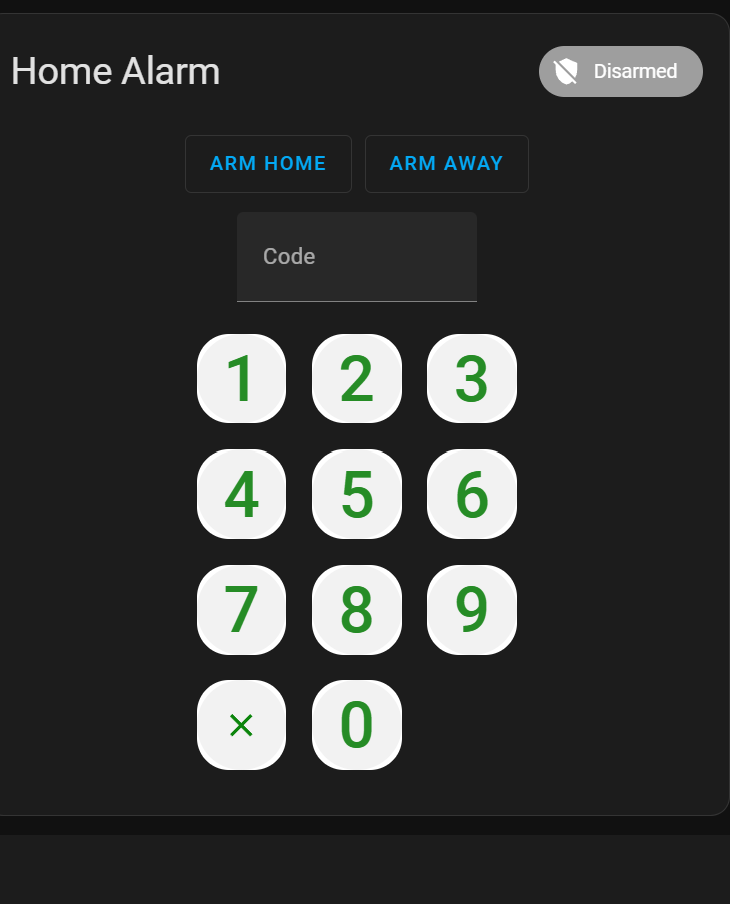

Yes, I try to increase key size (circle + font size)
a start
card_mod:
  style: |
    ha-control-button {
      font-size: 40px !importaNT;
      border-radius: 20px;
      background: white !important;
Let me know if you need additional assistance

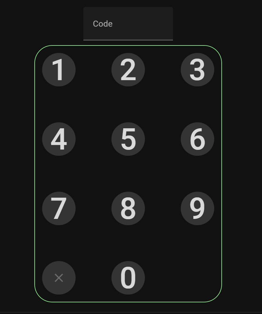

I have a last request.
I set background button to transparent, and I would like to increase size of the grey circle (probably a “clickable area” ?)
Here is the code :
    card_mod:
      style: |
        ha-card {
          background: transparent;
        .keypad {
        gap: 60px !important;
        border: 1px solid lightgreen;
        border-radius: 30px;
          ha-control-button {
          font-size: 50px !important;
          border-radius: 10px;

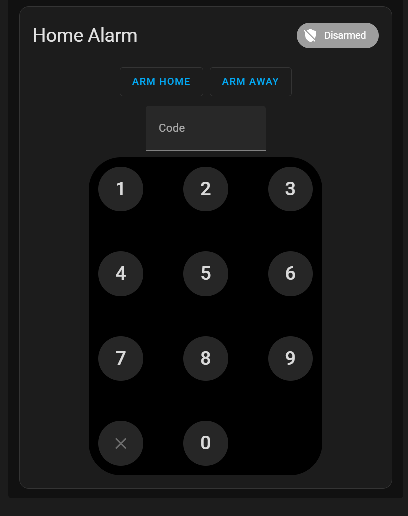

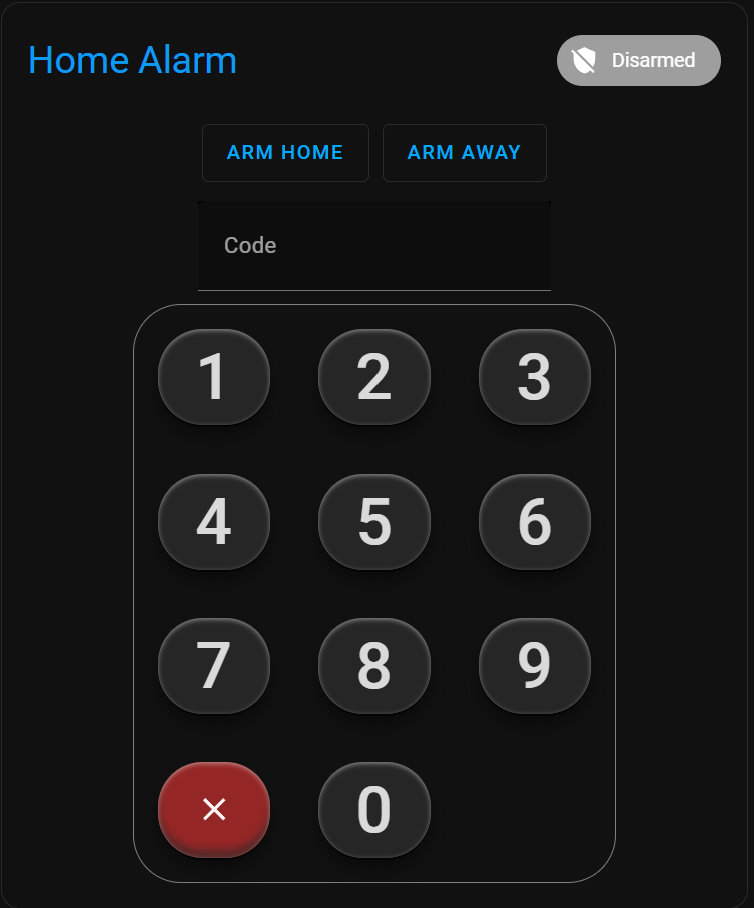

A little fancier
type: alarm-panel
states:
  - arm_home
  - arm_away
entity: alarm_control_panel.home_alarm
card_mod:
  style:
    ha-control-button$: |
      button{
        --ha-ripple-color: lime;
        background-color: black !important;
        box-shadow: 0px 1px 0px 0px rgb(0,0,0),
        0px 7px 10px 0px rgb(10,10,10),
        inset 0px 1px 3px 0px rgba(250, 250, 250, .5),
        inset 0px -5px 5px 0px rgba(0, 0, 0, .6);
    ha-control-button:nth-child(10)$: |
      button{
        background-color: darkred !important;
        color: white !important;
      ha-card {
      .card-header {
        color: #0d9af2;
      .keypad {
        padding: 15px !important;
        gap: 30px !important;
        background: none;
        border: .2px solid grey;
      ha-control-button {
        font-size: 40px !important;
        height: 60px !important;
        width: 70px !important;
      ha-textfield {
        max-width: 300px !important;
        width: 220px;
        background: black !important;
Thanks a lot !
That is exactly what I looked for.

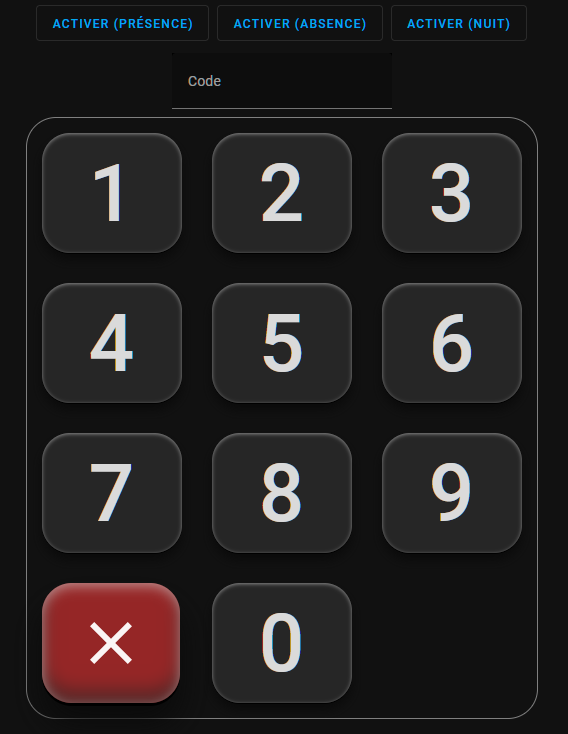

Is use this on a wall tablet (10’’) so I need to make it bigger.
I rescale all by 3 2 (font-size: 80px instead of 20px 40px).
At first try, I had an issue with the red cross symbol, which is not affected by font-size, and stayed at same size, which looked a bit tiny !
But I managed to achieve this by rescaling the button (maybe there is a much simplier way to achieve it)
As I rescaled this button by “3” (with “2”, cross was still too small), I had to divide all the other parameters by “3” too, in order to match with the other buttons style.
So I added these lines in the ha-control-button:nth-child(10) field, and result is perfect !
            transform: scale(3,3) translate(33%,33%);
            height: 40px !important; #120÷3=40
            width: 46px !important; #140÷3 ~ 43.3 but 46px looked better
            border-radius: 10px !important; #30÷3 = 10
Complete card-mod code :
    card_mod:
      style:
          button{
          button{
            transform: scale(3,3) translate(33%, 33%);
          ha-card {
          .card-header {
            color: #0d9af2;
          .keypad {
            background: none;
          ha-control-button {
            font-size: 80px !important;
            height: 120px !important;
            width: 140px !important;
          ha-textfield {
            width: 220px;
Happy to assist!! Looks great :1234:
And yes, the 10th button had slightly different CSS properties. Well done!
