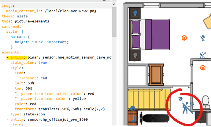

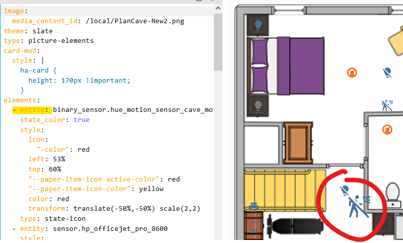

Hi, I’m unable to set the color of an icon. As you can see in the screenshot below, I know card-mod is working as the icon scale was modified but all my attempts to change the icon color failed. In the screen shot, I’m showing all three attempts (individually) and none changed the color of the icon. I also tried with both state_color being true or false. I used to have custom-ui active. I tried with and without custom-ui active and again, no change to the icon color. I tried different entity and all failed to change color. What am I doing wrong? Thanks.
Edit: I’m using card-mod 4.0.0

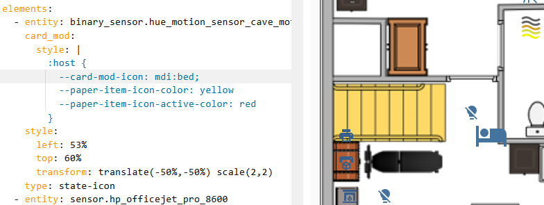

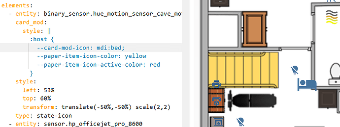

Edit 2: Using the examples in the card-mod HACS doc, I tried adding
    card_mod:
      style: |
        :host {
          --card-mod-icon: mdi:bed;
          --paper-item-icon-color: yellow
          --paper-item-icon-active-color: red
to the entity and as can be shown in the next screenshot, it DID change to a bed, but the color stayed to its default inactive (blue) :frowning: This is getting frustrating :rage:

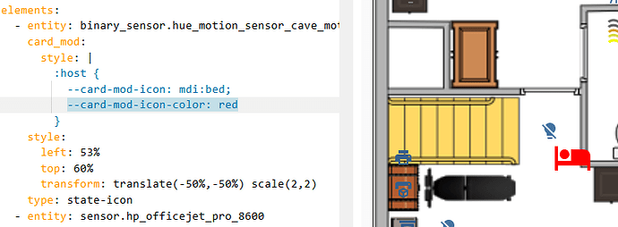

Edit 3: Got it working with
--card-mod-icon-color: red
Now I need to see if I can template that field…
