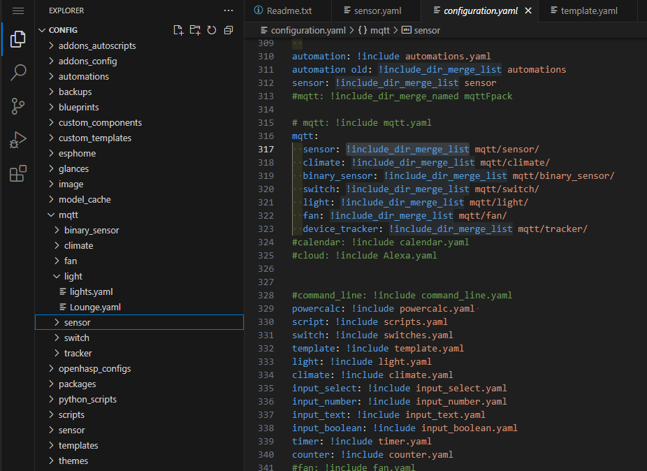

Here a Screen Shot of mine
I have started using
!include_dir_merge_list
this will load al files in said folder
in my mqtt\light folder I have to files make it easier to find read LOL
This is actually really nice and clean option, I complete miss the
