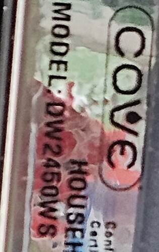

How do I check? Mine’s from around 2020.
If it’s from 2020 it’s a DW2450 or DW2450WS. Mine is from that year as well it will work.
The model number tag is on the left side of the unit when you open the door. It’s a little hard to see.
Yep! It was super hard to see.
