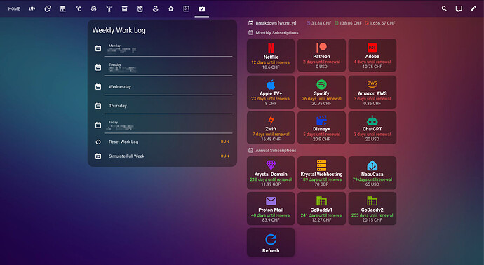

Simple Subscription Tracker
I’ve taken from this forum for years, and until now given very little back. I’d be delighted to get your feed back on this, more in terms of; is it safe, robust, clean, well structured, does it follow best practices - during the development, I ended up crashing my HA due to a nasty loop, so I’d very much like your feedback on ensuring this can’t happen again.

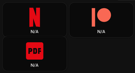

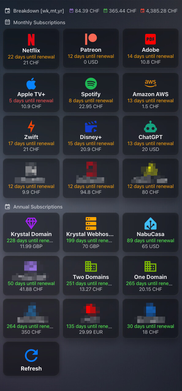

Lovelace button card - first three entries used as example. I manually sorted the order in the ui to have monthly and yearly separated, then split them up into two cards after that. Here I have one block per subscription (15copies!). I fought a lot on this bit, because I couldn’t find a way to loop inside a card. Perhaps someone can improve this part. The first button card below (netflix) has a tap function for demo purposes. Perhaps in the future I’ll add a sensor to track the cost of each individual subscription (for price tracking), but for now it does everything I need.
square: false
type: grid
columns: 3
cards:
  - type: custom:button-card
    template: subscription_card
      [[[ return
      states['sensor.subscriptions_list']?.attributes?.subscriptions[0]?.name ||
      'N/A'; ]]]
    icon: mdi:netflix
    label: |
        let sub = states['sensor.subscriptions_list']?.attributes?.subscriptions[0];
        return sub ? `${sub.cost} ${sub.currency}` : "N/A";
    state_display: |
        let days = sub?.days_until ?? 999;
        return `<span style="color: ${days < 7 ? '#FF5555' : days < 30 ? '#FFA500' : '#55FF55'}">${days} days until renewal</span>`;
    tap_action:
      action: more-info
      entity: sensor.total_monthly_subscription_cost
    styles:
      card:
        - border-radius: 15px
        - padding: 12px
        - background: rgba(0, 0, 0, 0.4)
        - box-shadow: 2px 2px 8px rgba(0, 0, 0, 0.25)
      icon:
        - color: "#E50914"
      [[[ return
      states['sensor.subscriptions_list']?.attributes?.subscriptions[1]?.name ||
      'N/A'; ]]]
    icon: mdi:patreon
    label: |
        let sub = states['sensor.subscriptions_list']?.attributes?.subscriptions[1];
    state_display: |
    styles:
      card:
      icon:
        - color: "#F96854"
      [[[ return
      states['sensor.subscriptions_list']?.attributes?.subscriptions[3]?.name ||
      'N/A'; ]]]
    icon: mdi:file-pdf-box
    label: |
        let sub = states['sensor.subscriptions_list']?.attributes?.subscriptions[3];
    state_display: |
    styles:
      card:
      icon:
        - color: "#FF0000"
And finally a few template sensors I used to track the costs in the header card:
    # Subscription Tracking Sensors
    subscriptions_list:
      friendly_name: "Subscriptions List"
      value_template: "ok"
