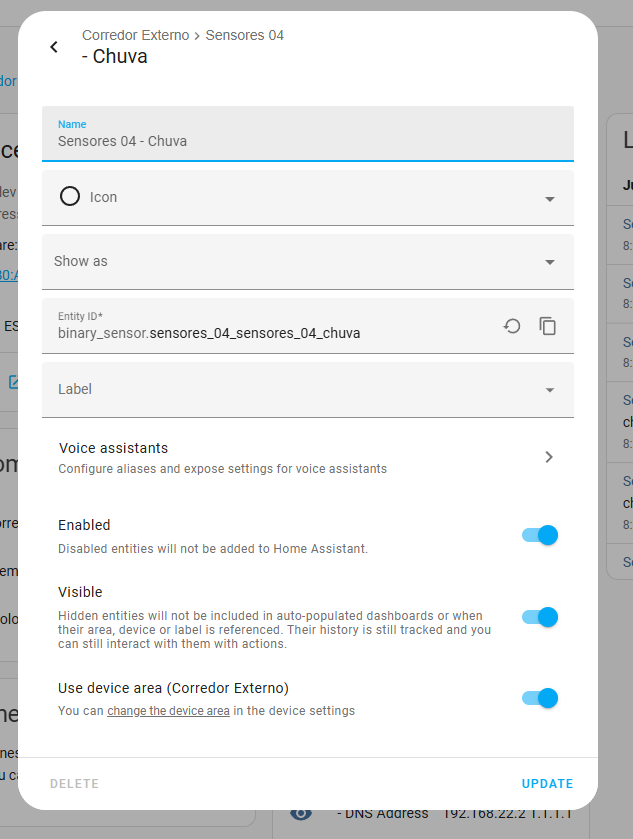

I’m using sibstitutions, but It’s working only in ESPHome and validator, I can’t get the names in Home Assistant. What am I doing wrong?

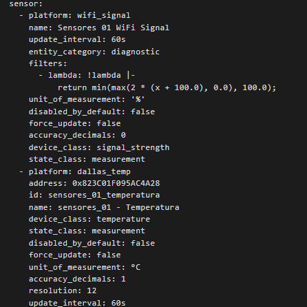

substitutions:
  hostname: 'sensores-01'
  device_name: sensores-01
  device_alt_name: sensores_01
  device_full_name: "Sensores 01"
esphome:
sensor:
  - platform: dallas_temp
    address: 0x823c01f095ac4a28
    name: "${device_alt_name} - Temperatura"
    device_class: "temperature"
    state_class: "measurement"
Validator seens to be OK

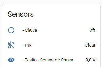

but in home assistant, I just got everything after the dash, no substitution at all

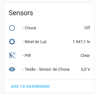

I think on the device page HA hides the portion of the sensor name that is a match to the device name. If you look at the sensor in other place, I believe you’ll see the full name.
You are right!
Doesn’t make sense to me, but it’s right!
