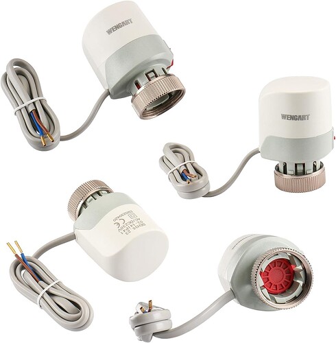

Thermal actuators and a smart plug.
Works great for me.
Like “build your own TRV” ? If so, that’s probably a bit too “home grown” in our case :slight_smile:
If I missed your point, I’d like to hear more!
Kind of.
But the only real technical is to put a plug on the wires.
They are sold like this:
So either a normal relay or a smart plug but then you need to put a mains plug on it.
Then you just add a temperature sensor in the room and add the switch and sensor to a generic thermostat.
Just keep in mind, these are on/off, nothing in between.
But it has worked very nicely here.

Make sure you get the right connector.
This might be a Danfoss RAV connector, but there is also a Danfoss RA and there might be other formats too.

That is why I say external temp sensor and mains powered actuator.
Yeah, i agree, but mains powered part is problematic… i don’t have any mains near my radiator, that’s why battery-powered is my only option. If battery-powered actuators are available it would be the win situation…
Regarding problems with sonoff - many people have problems with zigbee, so that could be the cause… sadly i didn’t see that sonoff have wifi valves. I did find no-name valves on aliexpress, but who knows if they work or not…
Some of our didn’t either.
But running the cable behind the radiator worked fine.
I have read some about it being inaccurate. It had like 1 degree as minimum accuracy on the set temperature.
I guess i could draw a wire somehow, built my own circuit with esp32 and i’m a winner.
I’m looking some of actuators on aliexpress, and some are even 24V, which is kinda safer, i guess. But what means NC or NO…?
NC means if power is lost, it will be closed (no heat). NO is opposite.
Keep in mind 24 v means a transformer to each radiator.
