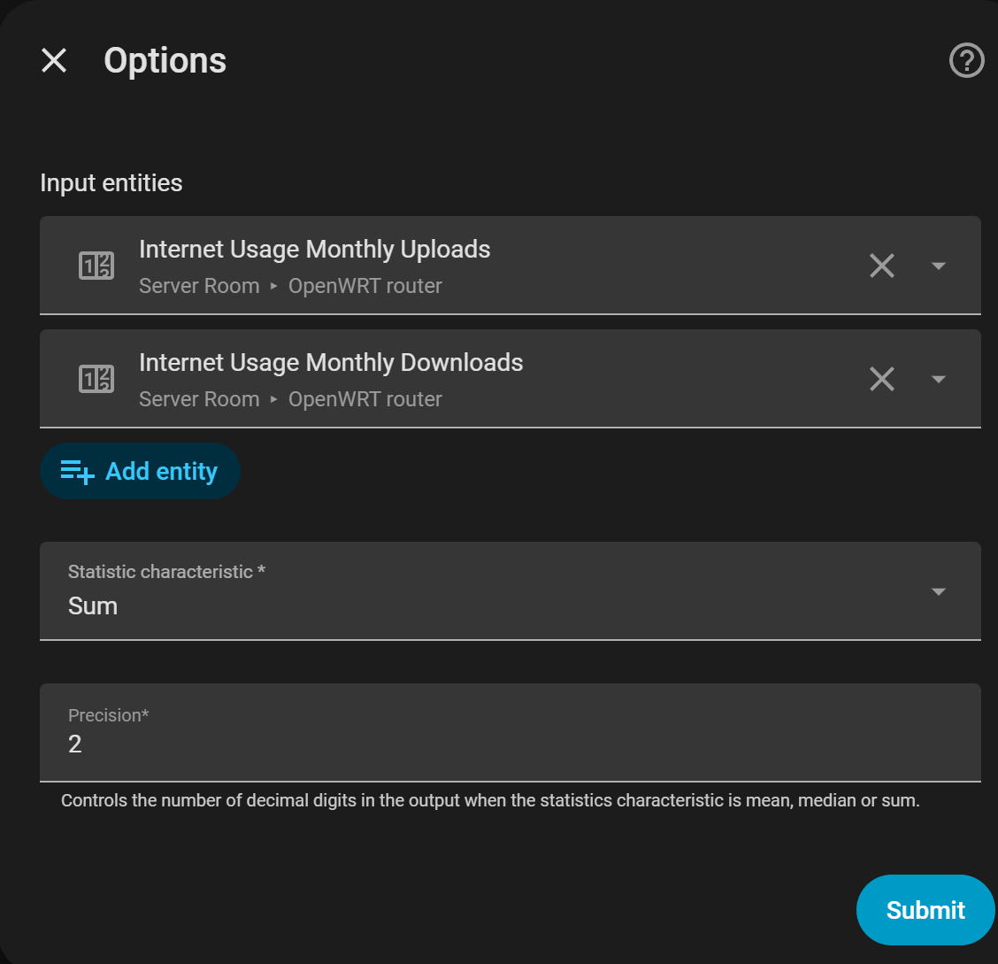

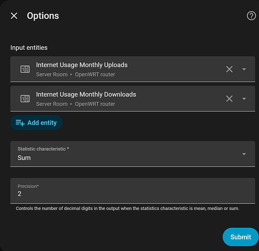

I have a simple “Combine the state of several sensors” helper that just sums two custom sensors (uploads and downloads) to create a total “internet usage”.
I’m trying to use the UI as much as possible instead of the YAML files, so this is what it looks like:

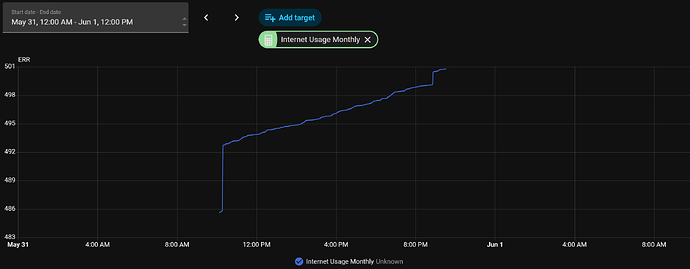

It works fine for a about half a day, but then stops outputting with what looks like a units error:
If I delete and re-create the helper, it will repeat the same cycle.
Before I abandon the UI and go back to YAML, am I doing something wrong here? The two source sensors are both Utility Meter helpers with “GB” units of measurement.

I haven’t seen anything in the logs at the time that reporting stops; but once it no longer works, there are a couple errors logged on startup:
Logger: homeassistant.components.min_max.sensor
Source: components/min_max/sensor.py:332
Integration: Combine the state of several sensors (documentation, issues)
First occurred: 9:39:07 AM (2 occurrences)
Last logged: 9:39:07 AM
Units of measurement do not match for entity sensor.internet_usage_monthly
So it’s consistent with this being a units issue, but I’m not sure how that can become a problem after the template has already been working; it implies that one of the source sensors unit of measurement is changing, but that shouldn’t be possible.
