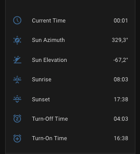

Sun and Time controlled ESPHome project
Hi this projoct is most wanted and most searched project type. I’am a retired man but I like programming. My carrier is, economics and software development but now I’m reteried old man :slight_smile:
but this codes work !
Our goal:
A program that turns the lights (or relay) on X hours before sunset or Y hour after sunset, and also turns the lights off Z hours before sunrise or T hour after sunrise.
Main problems:
  • There are not enough components, in fact there are but no one that does this job easily
  • You need to try different ways to reach your goal. While everyone wants the same thing, I couldn’t find a complete solution in my research.
Requirements:
  • an ESP board with wifi and internet connection, of course
  • a relay
  • connection and power cables, power supply and some coffee
Main features:
  • espHome setting: minimum req, works with internet connected wifi and ESP-01
  • HA independent (for standalone work, but everyone know HA is the easy way to achieves our goal)
  • time sensitive,
  • full automatic
  • easy use for users
  • easy customize
  • settings can be controlled via web interface, or HA or both of them
  • only esphome’s built in components, no extra or other, or github or component or script used
  • can be invert funciton, like if you want to close relay when sunset and open relay on sunrise, easy with one switch (Invert func)
solution:
  • A few duplicate components, even a copy of a copy
  • A few lines of lambda
  • used components: sensor: , number: , datetime: , select: , sun: , time: , switch: , text_sensor:
Work this order:
1- time: (input lat, long in yaml)
2- sun: get info from time: → output sunrise, sunset time, evelation and azimuth
3- datetime template gets sunrise and sunset time → and calculate relay open and close time delay with number: component even with delay
4- no one can’t get calculated time (HH:MM) with normal properties like, .state value :frowning: for this reason use middle in the man strategy, we use another datetime template and some lambda, first ones push data to second one, second one is push text template to dispaly turn off time to user at UI,
5- datetime component on_time: section open relay or close with state of (TRUE/FALSE) switch: wich is run close or open at the time like INVERT func
Conclusion:
I tested and works, Does enyone interest this type of code

Post some code and logs to see what you’ve done. (Use formatting so we can see if there are any spacing issues)

Major bug & Update:
  1. timzezone settings:
time:
  - platform: sntp
    timezone:  "Europa/Istanbul"    # https://github.com/nayarsystems/posix_tz_db/blob/93447c0ddac304ca6672a5fd905261c7e8905159/zones.csv
timezone paramater MUST like
timezone:  "<+03>-3" # "Europa/Istanbul"
because string type “Europa/Istanbul” works wrong, you can find this TZ code at GitHub TZ database link
  1. I’am not sure but if your yaml settings refers to HA api connectin like below
api:
   encryption:
     key: "xxx-xxx-xxxx---xx="
time: timezone settings don’t work, I think HA time setting push to or crushes local settings, but not 100% sure .
I’ll inform you, after test and solve the problem later.
Hı, I tested it, when you set timezone like
timezone:  "<+03>-3"
and
api:
works fine, not override HA timezone settings to EspHome settings, feel free to use api: parameter
:slight_smile:
