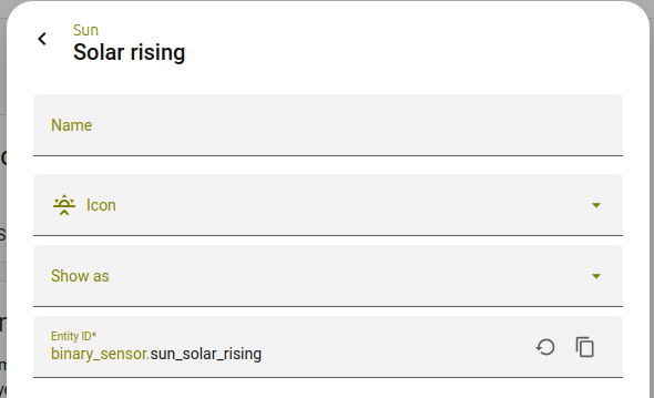

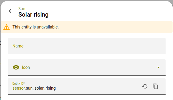

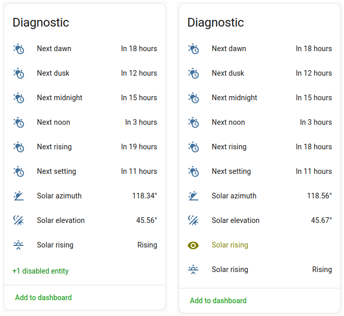

On both of my current Home Assistant installations there currently is a Diagnostic sensor offered for the Sun integration with the name Solar rising and the entity name sensor.sun_solar_rising
This sensor was not enabled by default. When I enable the sensor it is permanently shown as unavailable.
Note that there also is a binary sensor available with the same name Solar rising and entity name binary_sensor.sun_solar_rising
This sensor is functioning properly.
This are some screen grabs showing the sensor disabled and enabled:
And these screen grabs show the properties of both the sensor and binary_sensor:

It's been deprecated, apparently: Finish removal of sensor.sun_solar_rising (#157606) · home-assistant/core@972ed4b · GitHub
Not sure why it still shows as an enablable sensor, it does for me as well.

One of the main Home Assistant coders karwosts did respond on GitHub.
A work around to solve this issue for now is:
  • enable the sensor → it will then be unavailable
  • restart the HA server → after that the sensor will be unprovided
  • delete the sensor via the properties cogwheel → it will then be gone permanently
