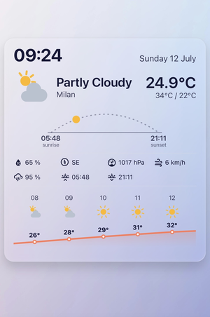

Hi everyone,
I’d like to share a custom Lovelace card I’ve been working on: Sun Weather Card.
It started because I wanted a weather card that also showed the sun’s position between sunrise and sunset.
What it does:
  • Current conditions header – time, date, animated weather icon, current temperature, today’s high/low and location
  • Sunrise/sunset arc – the sun (or the moon at night) moves along a dotted arc between sunrise and sunset

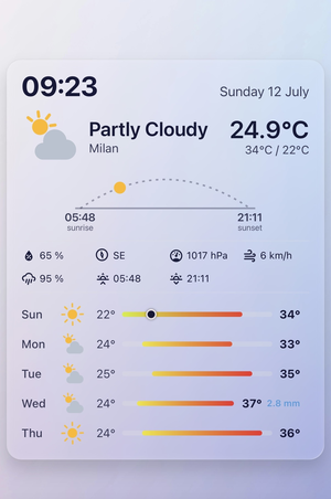

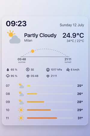

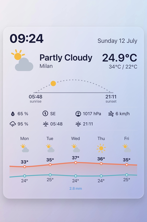

  • Two forecast layouts – classic iOS-style temperature bars, or a smooth line graph with max/min curves
  • Daily or hourly – both work with either layout
  • Configurable details – pick which attributes to show below the arc (humidity, pressure, wind, precipitation, UV, sunrise/sunset and more). Each one only appears if your weather integration actually provides it
  • Modular – time, date and the sun arc can each be turned on or off, so you can build anything from a full dashboard card to a minimal forecast-only view
  • Original animated SVG icons – sun, moon, clouds, rain, snow, fog, wind, lightning. No external assets
  • Full UI editor – configure everything without touching YAML
  • Light/dark theme support, English/Italian/system language, tap/hold/double-tap actions
