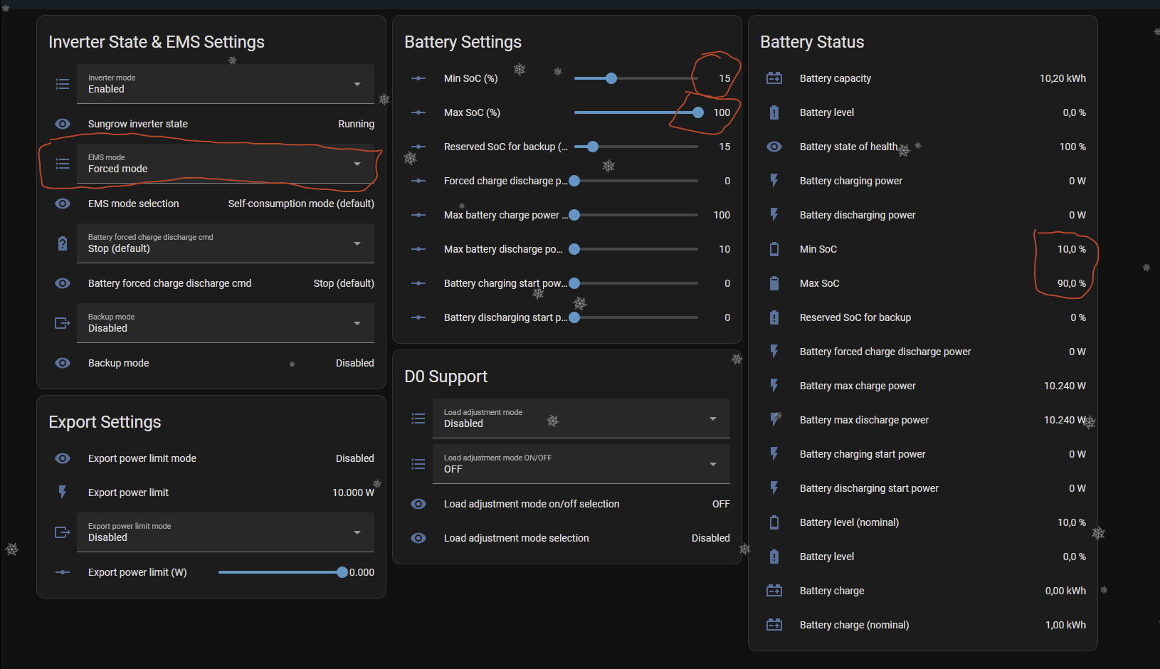

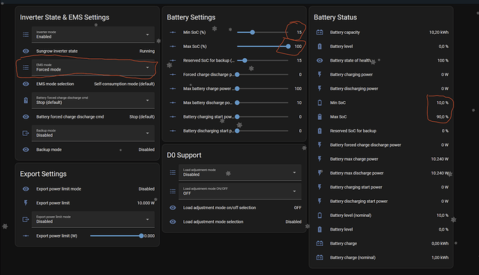

Hey there,
I’m using HA and the Sungrow Intergration via Modbus for half a year now and all things running good so far. All information show up with correct value/ state.
Last weekend I set up a battery for first time and even their values are correct.
Now I wanted to steer the battery/ inverter with the sliders and drop-downs to set min and max SOC but nothing is happening. (see screenshot above)
Is there a know issue?
You could also install the “EVCC Addon” and the “EVCC Integration”.
The opensource EVCC project is made to control EV charging, but has “native” support for Sungrow inverters, so even without an EV you can control your inverter and see lots of entities from your inverter, via the integration, in Home Assistant.
Had no clue this existed and installed it this morning, amazing add-on and integration. Works seamlessly with my inverter over the modbus IP.

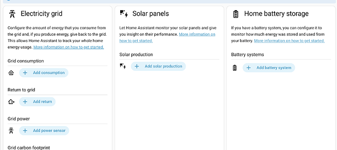

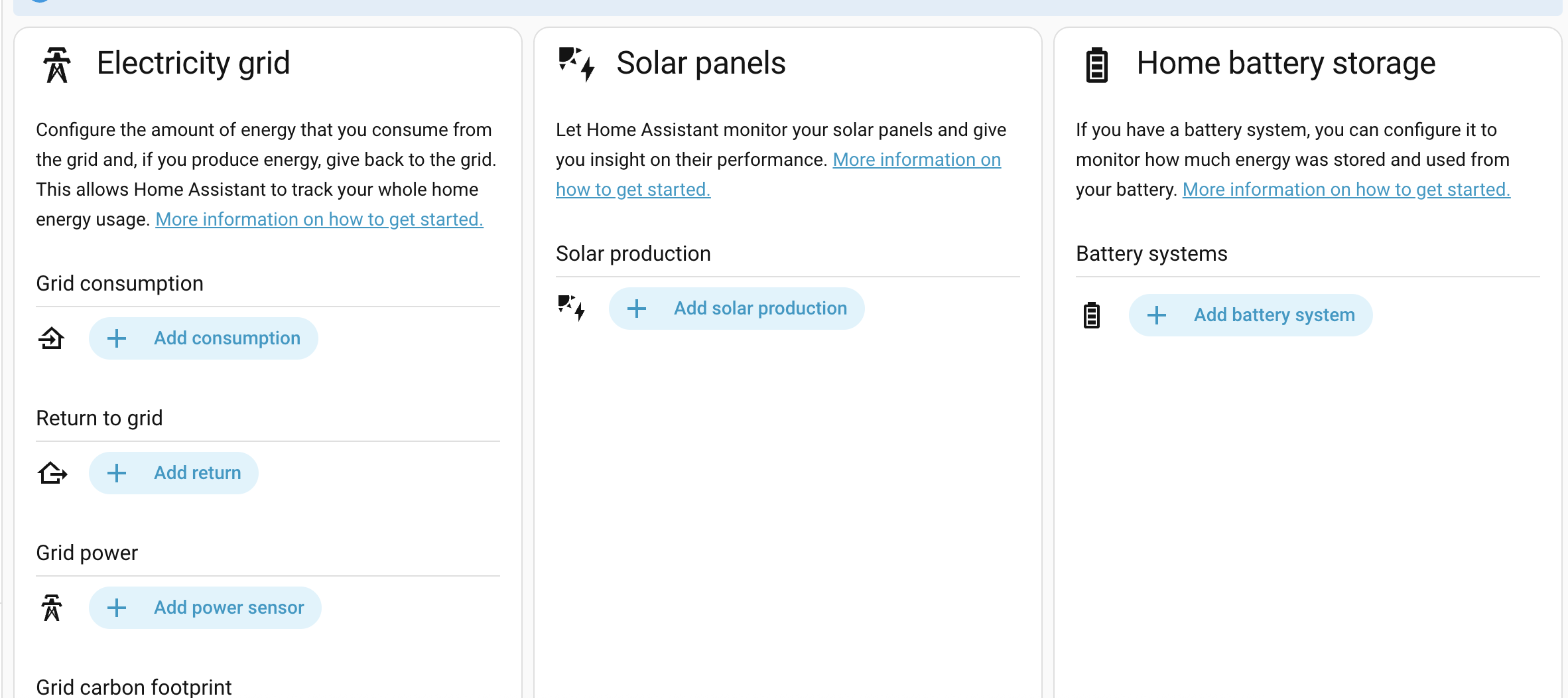

Still can’t get this for some reason to work with my Sungrow SH10.RS for the life of me. Considering EVCC had it out of the box and it just worked makes me more confused.
Any clue which sensors would be appropriate from EVCC to feed the “Energy” fields in HASS?
