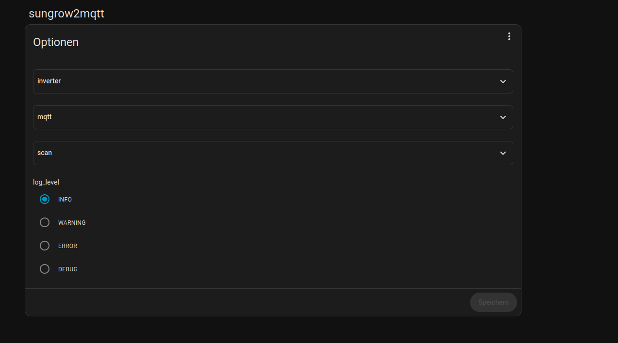

Hey, I took the time to create this Home Assistant add-on and to implement and further develop existing projects. I used MKaiser’s configuration YML as a basis, which is automatically fetched from his repo every time the system restarts, ensuring that the latest registers and sensors are always available.
Screenshots
