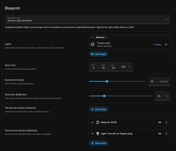

For reference, here is my automation using the bedroom situation I described earlier:
Many thanks for screenshot - that’s helps for sure. Ironically I slept though the “rise” this morning, but I’m going to test it again soon.
