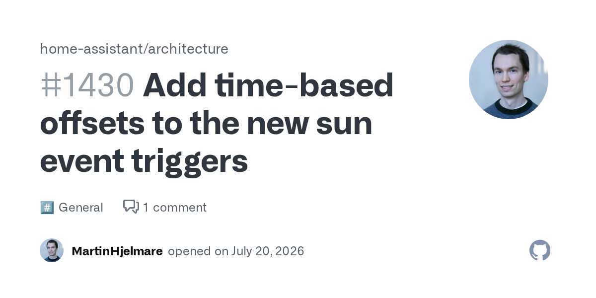

There is activity underway to add the offset functionality into the new triggers:

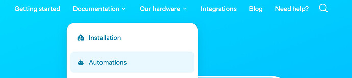

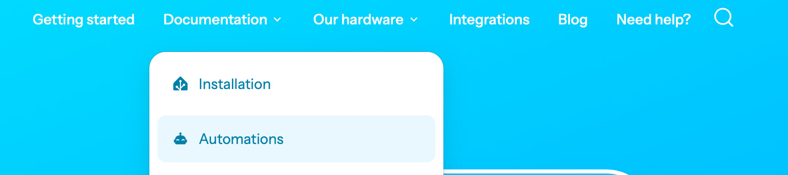

Somehow when looking in the Automations link, there is no pointer to the newly added purpose specific triggers… not even when you click through. Which doesnt help spread the news.
But, reason I posted, was that the original trigger OP used should still be valid. If that doesnt trigger, something else must be off
maybe I misread myself, and OP only found that the offsets didnt yet work…
o well. they soon will in that case
