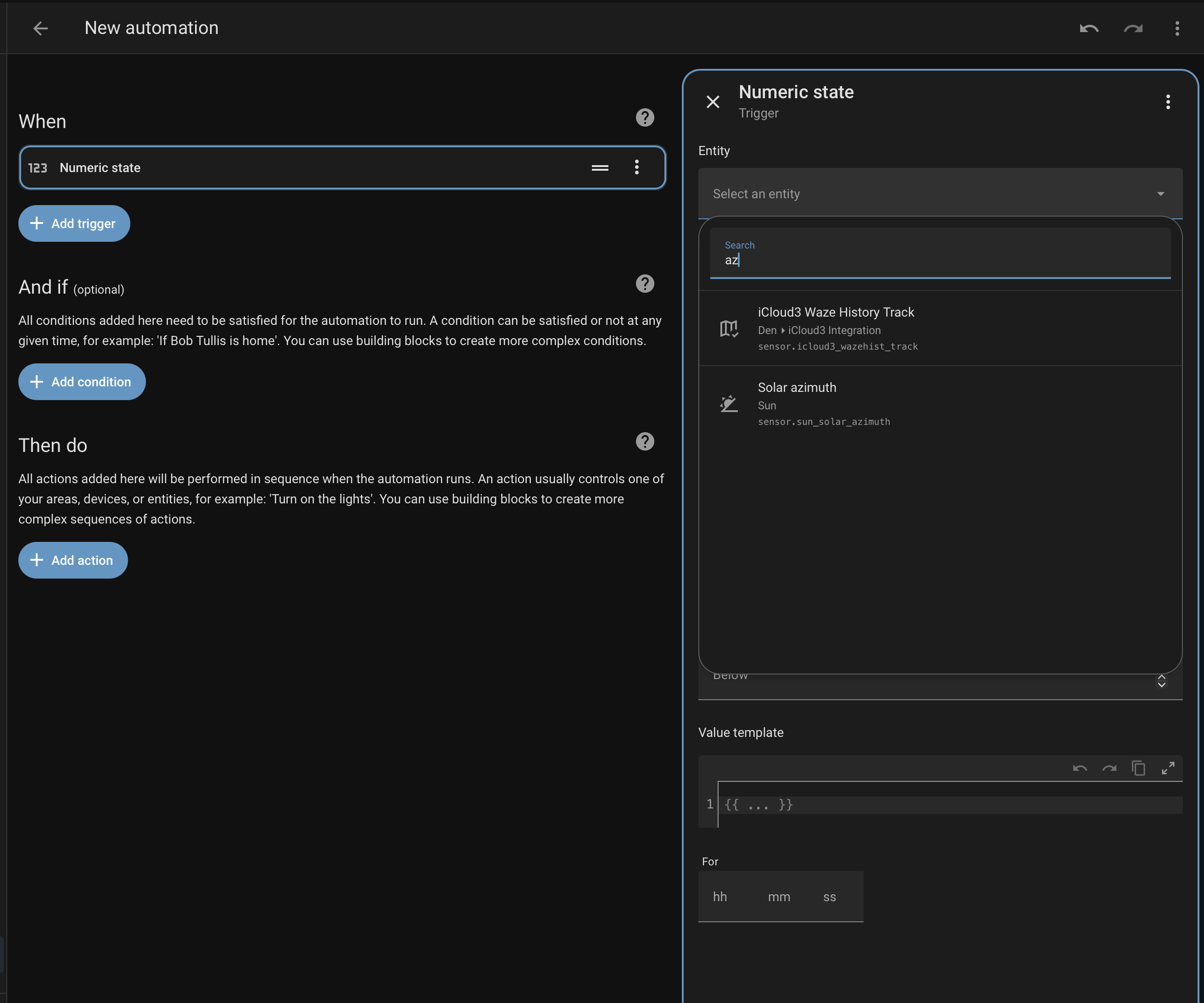

As a trigger in an automation, by selecting Entity / Numeric state, then manually typing in “azi” that should provide the azimuth sensor from the Sun Integration.
Similarly, typing in “elevation” should provide the Sun elevation entity.
I believe azimuth and elevation are disabled by default. If the entity does not populate go to the sun integration and click on disabled entities, then enable them.

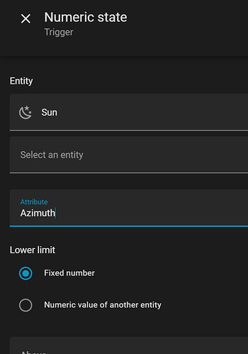

You don’t even need to enable the azimuth sensor unless you want it cluttering up your LTS. It’s also reported as an attribute of the sun.sun entity, so you can just do this:
trigger: numeric_state
entity_id:
  - sun.sun
attribute: azimuth
above: 25
