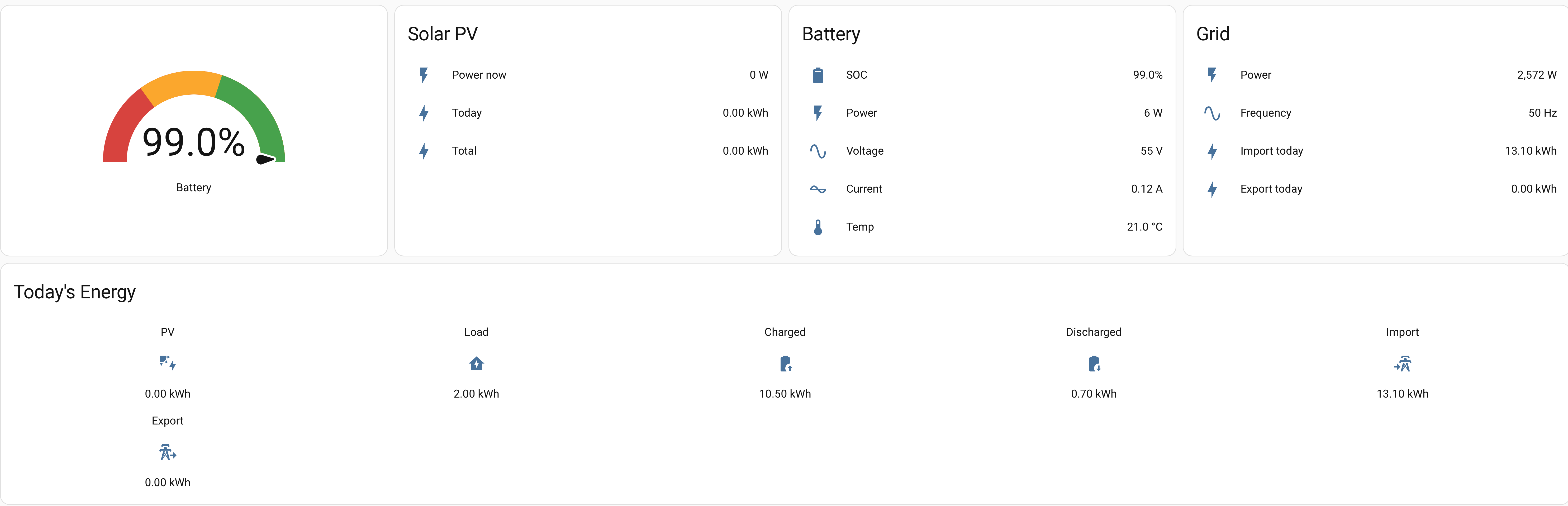

I’ve developed a native Home Assistant integration for SunSynk / Deye hybrid inverters and I’m currently looking for beta testers :grinning_face_with_smiling_eyes:
The integration currently uses the SunSynk Cloud API (not local logger polling).
Current features:
  • PV generation
  • Battery SOC
  • Grid import/export
  • Home Assistant Energy Dashboard support

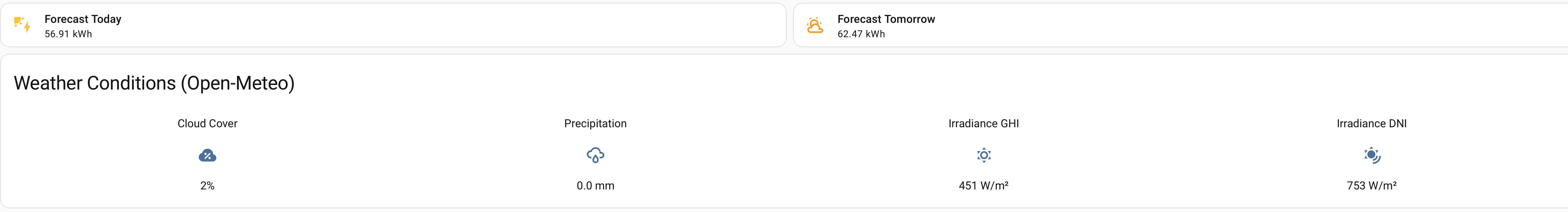

[UPDATE] Solar Forecast sensors added, Open-Meteo integration, no API key needed
Quick update on the integration, new feature landed today.
What's new: Solar Forecast
Six new sensor entities powered by Open-Meteo (free, no account, no API key):
Sensor Unit
Solar Forecast Today kWh
Solar Forecast Tomorrow kWh
Cloud Cover %
Precipitation mm
Solar Irradiance GHI W/m²
Solar Irradiance DNI W/m²
The kWh forecast is calculated as Σ(GHI per hour) / 1000 × panel_kWp × performance_ratio - so it accounts for your actual installed capacity and system losses, not just raw irradiance.
Setup
Go to Settings → Devices & Services → Sunsynk → Configure and fill in one field:
  • Panel Peak Power (kWp) - your total installed panel capacity
That's it. Latitude and longitude are pulled automatically from your HA home location. You can override them if your panels are somewhere else (e.g. farm/remote install).
Data refreshes every 30 minutes.
