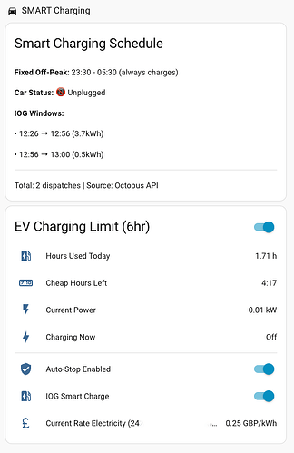

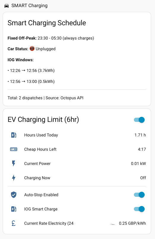

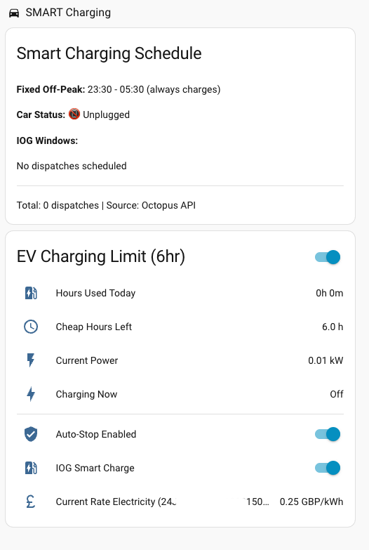

I’ve finally got a version I am happy with … jeez that was a journey.
During my time on this, Octopus changed the tariff with a 6 hour charging limit. I’ve added a timer in HA which will give me the option of stopping the car charge before it goes onto peak rate.
We also had a time where the Octopus API was down and then with a silly long latency of around 15 minutes. It’s unclear if they bill against the delay or not and I won’t know until I get my bill. To deal with this I’ve installed Shelly device which can sit independently and cross check the system… IE the car should not be charging at peak rate and the battery should not be discharging to the car.
So I’ve ended up with quite a complex system with layers and controls. In the main, I am using Node Red and using Solar Assistant as my MQTT Server. As SA is connected directly to the SunSynk Inverter it’s quite a neat way to control it.
I have separate flows in Node Red which helped with the development process as I could focus on one aspect at a time… but it’s grown arms and legs a little. I should add, I am no coder. I’ve worked on the documentation and I copy and past the code from Claude ai.
A few key things I found. Firstly the SunSynk doesn’t like working in a “Timer Off” mode. I was just going to turn off the timer and control it from HA but even after a firmware update this didn’t work. I had to live with the timer on and update the time slots… which adds a lot of complexity. I protected timer slots 1, 2 and 6 to give me fixed off peak timing. Time slot 2 which is the end of time slot 1 begins and ends at 05:30.
I also have a time slot clean up process which I run just in case. I found you need to allow for delays in the SunSynk accepting MQTT commands which is a problem SA also has so this way we tidy up after a charge session.
At first, I avoided this on the basis that I wanted to keep it simple but I’ve ended up using the Dispatches attributes from the Octopus API. The dispatches change all the time including in mid charge but the big advantage is I can see what is planned to happen. It also avoids delays where I might be charging on peak or discharging the battery to the car.
So it’s become a bit of a monster but it’s working now. IOG can do what they like and I wont discharge my home battery into the car and I won’t charge on peak.
