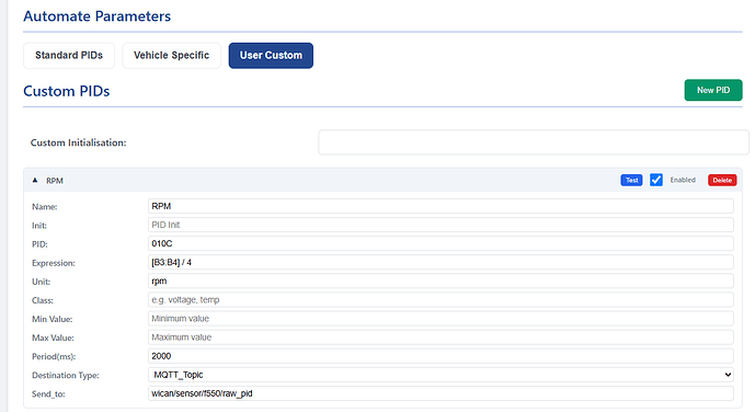

Would this fork help with the Wican Pro in silent mode? I’m trying to use it with the Banks Idash and when I plug the iDash back in, the Wican Pro stops working. Would this fork work with the Banks iDash?

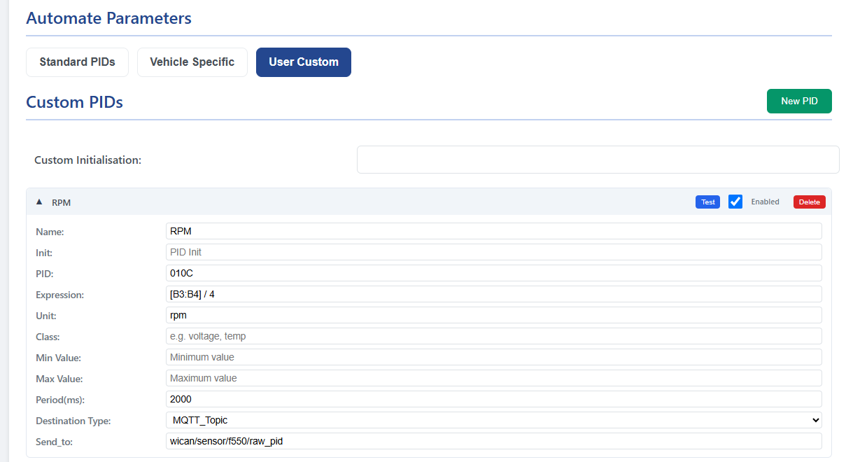

Thanks for getting back to me. Attached are some screen shots of my current setup. When I use ELM327, I cannot get anything to work. I’m not sure what you mean by ATCM or ATCF. Do I need to install the fork to see that?
On your 2nd screenshot, he’s talking about the Custom Initialisation field and the PID Init field for each sensor. Those are where you put your vehicle’s commands in order to request the data for your sensor. This is also where you may need to do some “legwork” in order to find out what they are. Referring to the WiCAN wiki, you can use the Car Scanner App to help you figure those out. However, some vehicles have multiple CAN’s that are ran on different bitrates and Car Scanner, in my experience, only polls the HS-CAN at 500. For example, if you have a Ford, Ford has a proprietary MS-CAN at 125.
FWIW, the way I figured my data out is using FORScan and WireShark. Made it super easy to find my Global Init string and each sensor’s PID init strings. Good luck!
