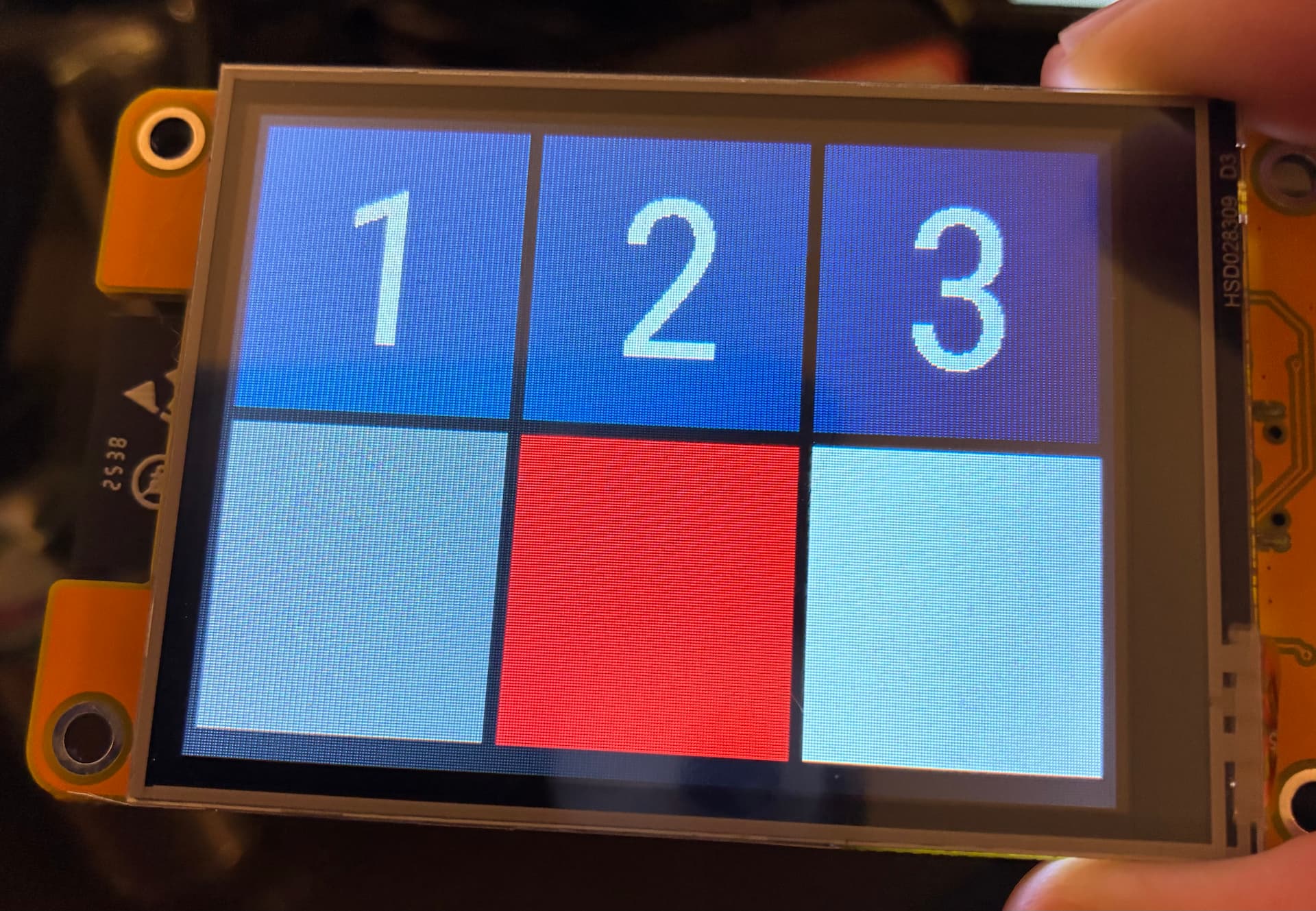

It’s been a newb journey but i am finally successfully turning lights on and off with buttons i set up on a CYD. But why isn’t this code working to change a bulb’s color? Any help appreciated, hazing authorized. Thanks!

Thank you so much! I broke through to a finished product with this point in the right direction.
