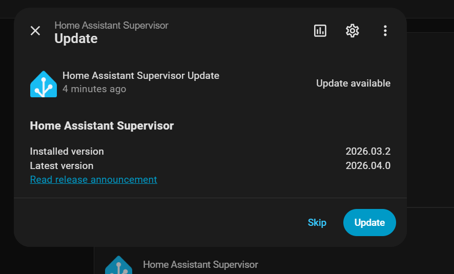

Supervisor 2026.04.0 fails to install
I am trying to do an update of my HA supervisor. It fails every time. See attached msgs. Never had any issues with updates till now. Any ideas? See error msgs and info below.
Btw, After a couple of attempts to update Supervisor, the system becomes unresponsive and requires a reboot.

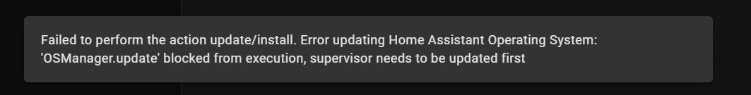

In random order of questions above, it is a bare metal HAOS install on a generic PC that is several years old. Memory, CPU, and storage are all below 10%. There is no VM layer other than whatever HAOS builds itself. I have no DNS issues, and other updates have succeeded since this Sup update started failing repeatedly. The system mostly works until I try this specific update which is BLOCKING most other updates like core, and os. It is also blocking a few of the app updates. All say the same thing. Sup must be updated FIRST.
Is there a way to manually download, verify, then install this update through the console? I have gone through a bunch of the console commands and found no way to do it.

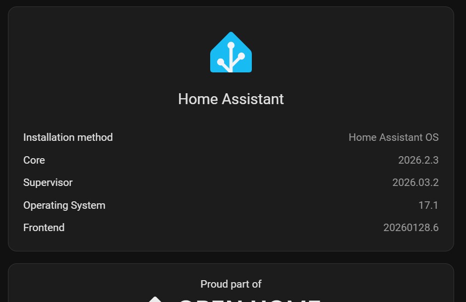

Just out of curiosity, how/when did you get Supervisor 2026.3.2 , as your Core is 2026.2.3 ?
Normally there is no reason to manually install supervisor, as it in stall automatic, i.e in this case with core 2026.3.2
