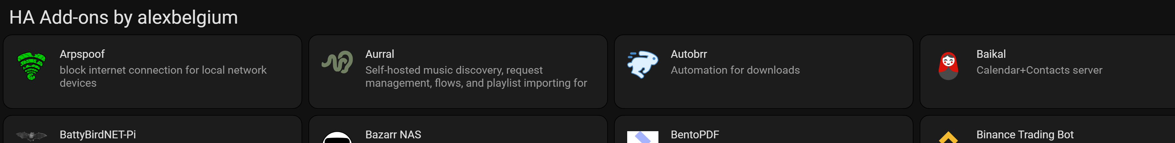

All of these are actively being maintained by alexbelgium so you would be looking for
https://github.com/alexbelgium/hassio-addons in your custom repositories.

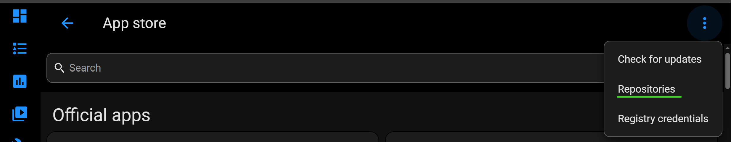

Do you see this :down_arrow: in your App Store?
EDIT: Installed the respository and see your issue!. Your best bet is to open an issue here: alexbelgium/hassio-addons or ignore the errors until it’s fixed.
