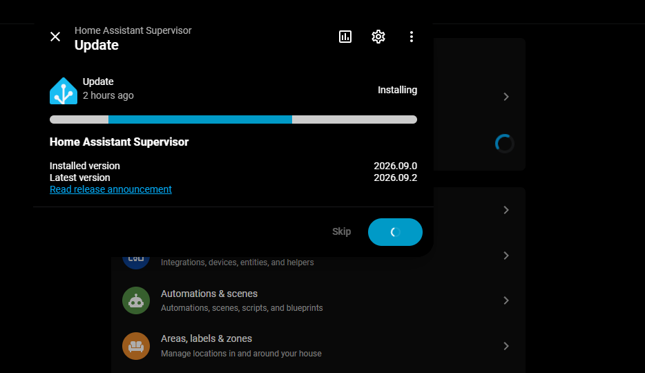

Supervisor Possibly stuck in installing stage
Noticed the supervisor has self auto installed itself, but it has not finished as it usually do. Coming up the 3 hour mark. Afraid too perform a restart. What should I do?
I’m not telling you to do this.
But this is what I would do.
I’d click on the X in the top left of the dialogue box and stop it.
Press refresh on the web page.
See if it did actually install, as sometimes it could be your browser or local net issue interrupting a UI update informing you of completion. You might be lucky. If not, I’d reboot, then try the update again. If it fails again, you need to get deeper into diagnostic territory. You would need to post more info.
Take a backup before reboot if you can, just in case. HA has always seemed pretty resilient to me. I’m sure it will be all good.

Refreshing the browser page does nothing. Even the mobile app is showing the spinning icon.
Looking at the supervisor log, the download failed and stopped trying. May it was suppose to stop itself and revert to the beginning of supervisor update available message, but did not for some reason??
