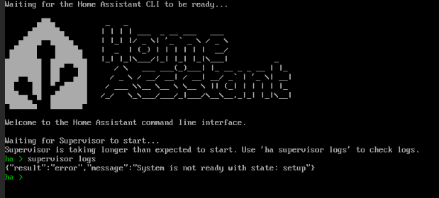

I tried to update my systerm to the latest version from the UI and it does not come back up now.
I am running HA on my proxmox.
I updated all add-ons, Integrations, etc.
Then I updated the Supervisor. Restarted, did not come back.
Checked console on Proxmox, was hung up on CLI to be ready. then dead.
I restarted many time, restarted my network, etc.
I restored my VM to the September image. then got it running.
Then I went through the process again, died again. I just got it to this point:
Trying to get some indication of what is happening. Nothing.

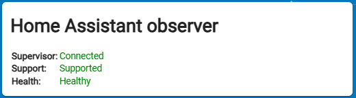

The crazy thing is when I check observer, I get this:

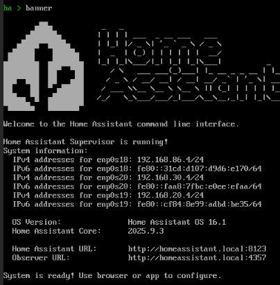

I went back to the known working version using VM Restore. and now have this:
I’m afraid to restart now in case I don’t get to this point again. I cannot however access HomeAssistant via the IPs.
for background, I have done no changes to the Proxmox, VM, or HA, other than update Supervisor to the latest from the HA UI.

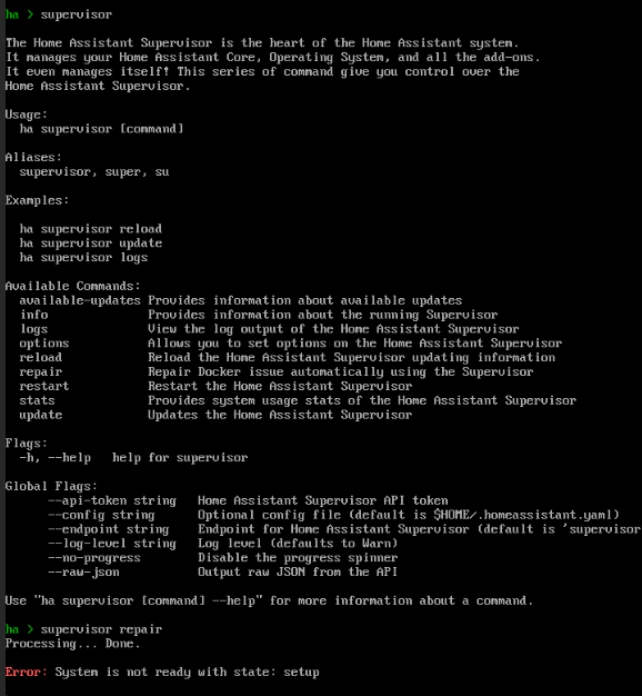

If the supervisor update falters it will try 3 times, then switch back to the other slot and boot as it was before.
There is also a cli command to select the slot and get slot status.
ha supervisor logs -vf would be the first thing I’d check.
