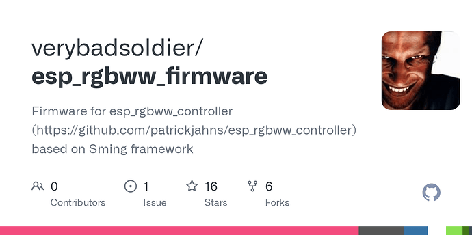

In fhem we are having a cool LED controller made by the community (hardware + software):
I am maintaining the firmware for the controller here:
The controller has some special (unique?) features. For example when connecting a RGBWW LED stripe (having dedicated warm white and cold white channels), the controller runs in HSV mode that also supports to configure the color temperature by mixing the cold and warm white channels as needed.
