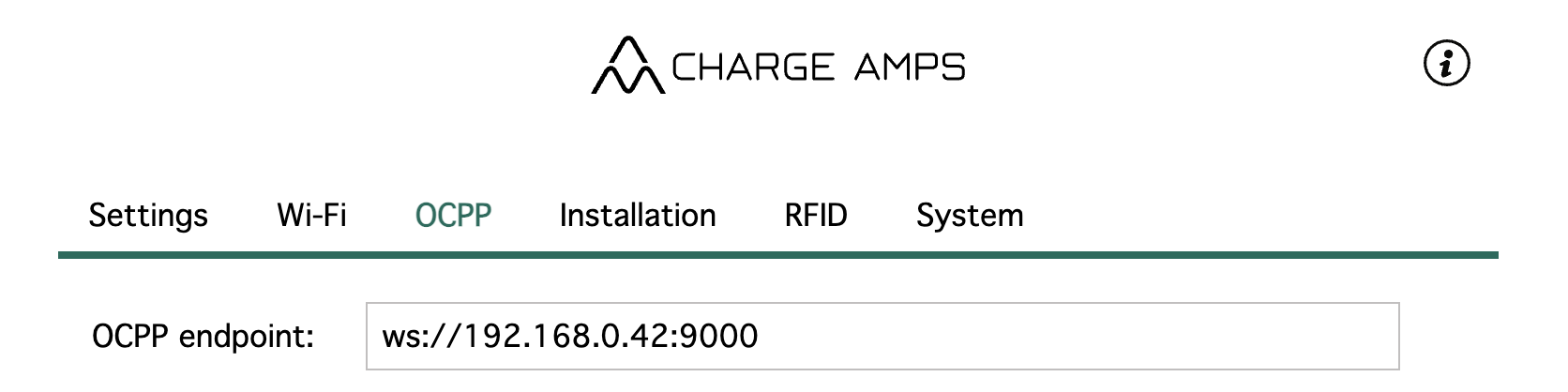

Anyway, Charge Amps supports OCPP, but I don´t manage to get HA to find my Charge Amps Dawn using HACS OCPP plugin. This should work, and I think it is the way to go to connect chargers to HA.
You’re right that OCPP support is the way to go for integrating chargers with Home Assistant. However, for it to work, there needs to be a way to configure the Charge Amps charger to point to Home Assistant as the OCPP backend/server. As far as I know, there’s currently no option to set a custom OCPP endpoint in the Charge Amps app—at least not the last time I checked. That makes it difficult (if not impossible) to get the HACS OCPP integration working with Charge Amps unless they add that functionality.
But maybe this is something that can be done somehow?
Hej!
Sorry for late response, have you got it to work?
In this thread is more on the solution I used:
There is an option now to set a custom OCPP server:
However, I haven’t been able to get it working yet with GitHub - lbbrhzn/ocpp: Home Assistant integration for electric vehicle chargers that support the Open Charge Point Protocol (OCPP)..
How do you access that setting? I can’t find it in Partner login.
