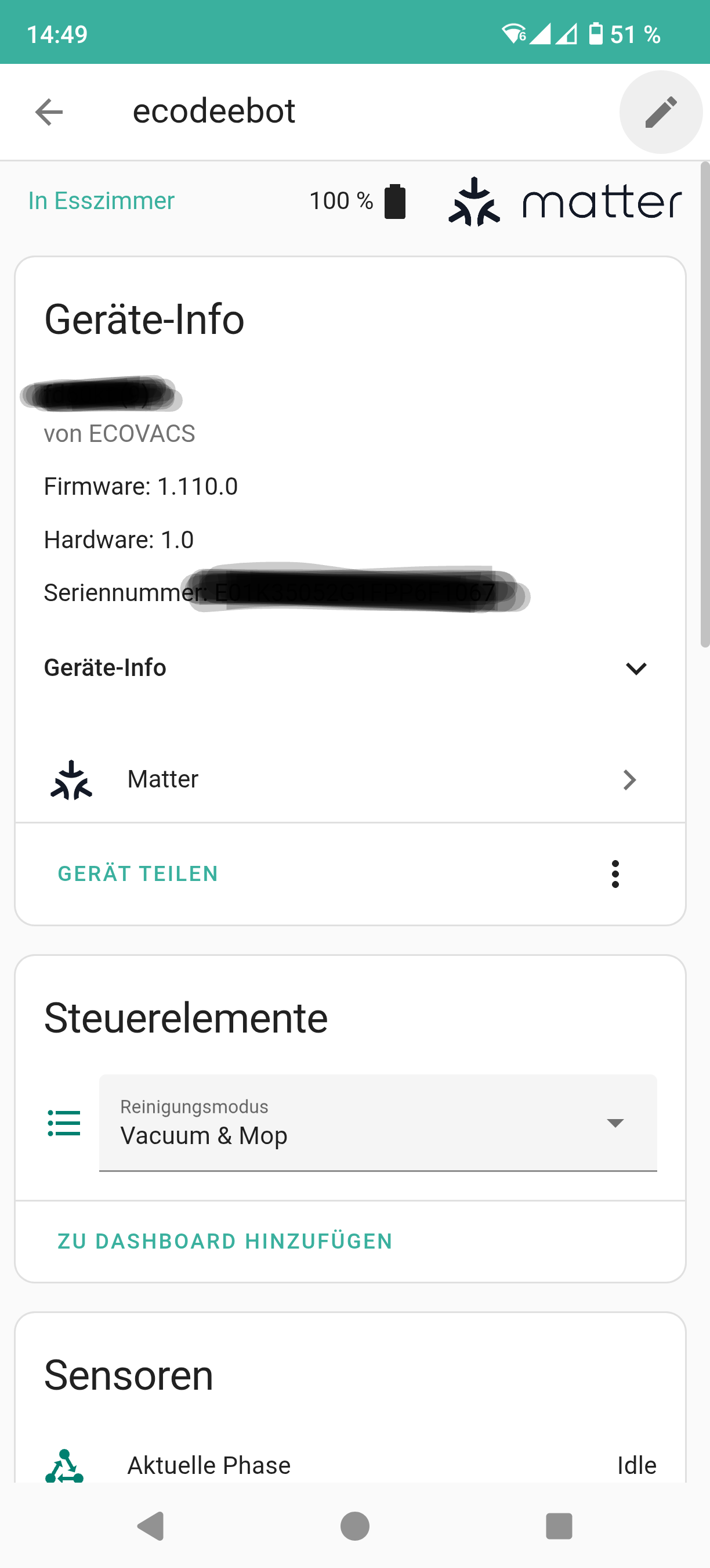

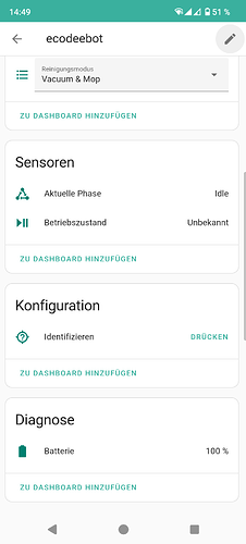

Update: They start releasing Matter Support in Germany today. After connecting I got only 5 Entities, missing the main vacuum entity for controlling the device
I just got the T50 Max Pro and while it’s recognized by both the official ECOVACS HA integration in 2025.5.3 and Matter there is missing functionality in both.
I tried adding it to Apple Home app via Matter and functionality looks complete there (can select rooms, start jobs etc) so it looks like the lacking Matter support is on the HA side not the bot itself.
I’m seeing the same issue with the limited entities for the main vacuum for the T80 Omni.

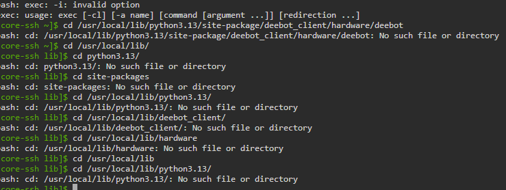

I have try with those commands but not works for me:
After many attempts, it has been updated, it seems that it is a very common problem. Thank you for your support.
Are you on HomeAssistant OS? If you are make sure you copy the first command in its entirety. Oh and I only tested it with Advanced SSH & Web Terminal with disabled protection mode.
My instructions are for HAOS, for other types of setup you will have to figure out how to get to the HA container shell (the first command that seems to fail on your system). As I don’t know specifics of your setup I can’t really assist you with that.

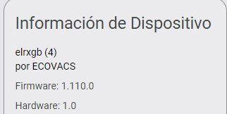

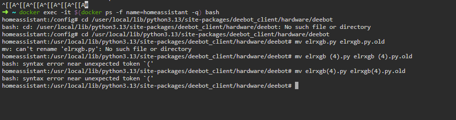

Hi again:
with you addon its works, but the command mv not working:
Its the hardware ID this one?
Thanks you

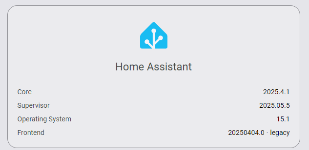

Update your HomeAssistant, you are running old version with an old version of Deebot client library and that is probably why the mv command fails. You can try skipping it and just doing the last command but I can’t tell if this will work.
It would be best if you update first, test if the bot is working and if you have issues starting the job then do the steps I described.
