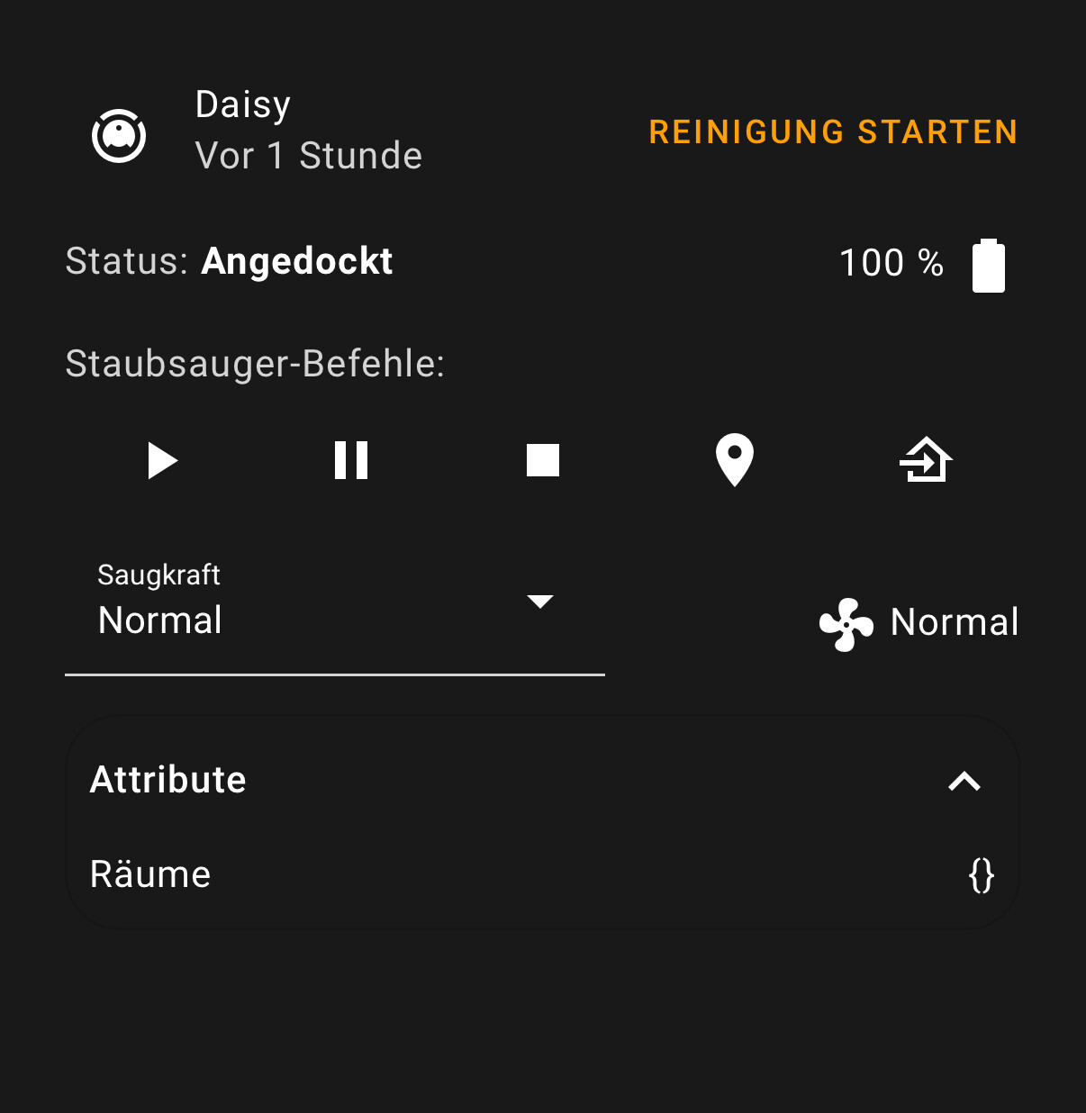

Hello all, I’ve bought a Ecovacs Omni T50 Pro and installed it in HA. I can start and stop the robot but can’t choose an area (room). Any idea why?
@oracle Did you use Matter over Wifi for the Integration in HASS?
I cant choose an area either.
I think Ecovacs didn’t implemented this feature into the Matter protocoll yet
I tried it with both, the standard ecovacs integration as well as the matter integration. There are less options in the matter integration. However, there are no rooms available in both. We may have to wait until they provide a fix.
Btw: If I use apple home, it works fine including the rooms.
They did. Area selection is available when controlling the vacuum from Apple Home app via Matter. Vacuum implementation in Home Assistant Matter Server seems incomplete.
When it comes to Ecovacs integration - client.py library does not currently support newer bots completely. Map, area, water amount, station functions etc support is missing or incomplete.

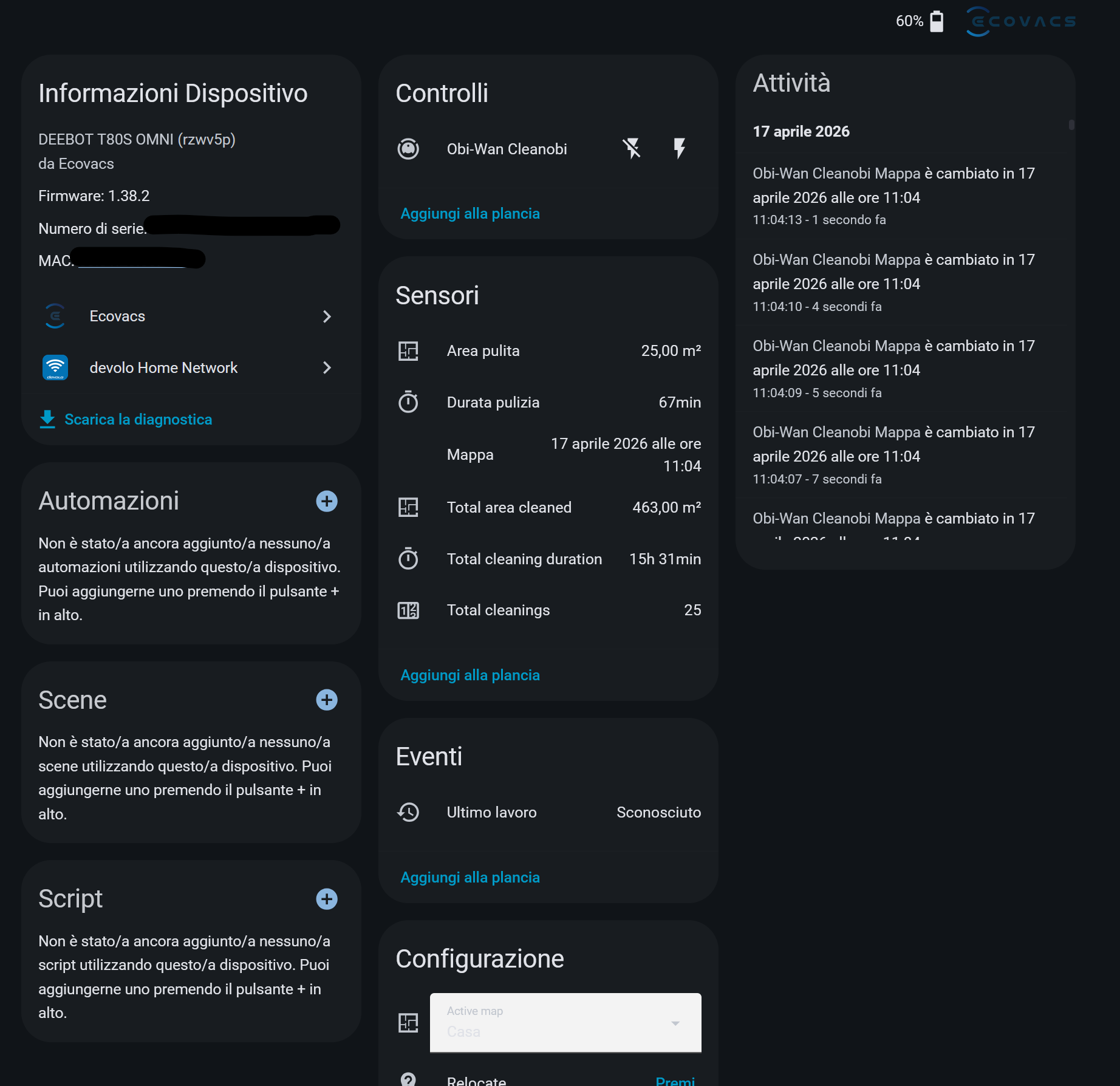

They did add this to HA with the 2026.3.1 release. You can now map the Deebot room names to area names in HA and then run automations based on those areas.
Although I’ve got a DEBOOT T80S OMNI I wanted to thank you A TON!
This worked like a charm (by using my device ID of course)! :smile:
