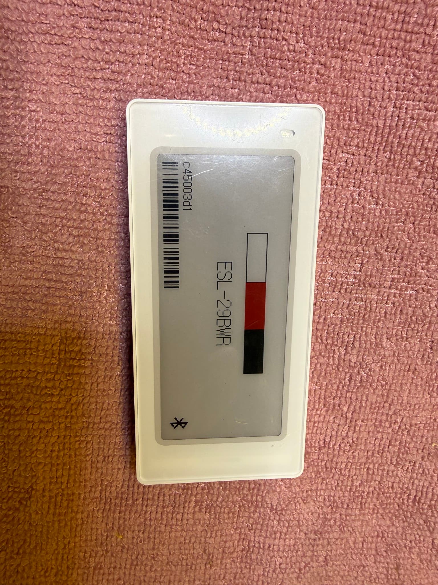

The ESL-29BRW does not even look like the gicisky counterpart
ESL-29BWR vs Gicisky 2.9
Edit: I can not show it, but the first screen at the deliver state looks also different

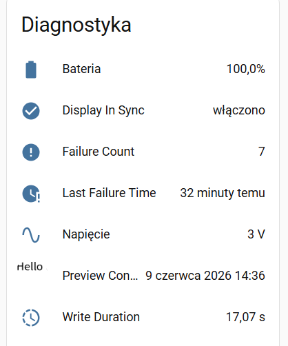

If you still havent found it (or someone finds this thread looking for solution) setting up esp bluetooth proxy exactly like in documentation did the job.
Initially put some custom yaml from AI that seemed to work but gicisky.write was failing after 3 attempts:
Write failed to FF:FF:92:99:24:37 (attempt 1/3)
Write failed to FF:FF:92:99:24:37 (attempt 2/3)
Write failed to FF:FF:92:99:24:37 (attempt 3/3)
after changing config to exactly:
esp32_ble_tracker:
  scan_parameters:
    active: true
bluetooth_proxy:
  active: true
it is working:
