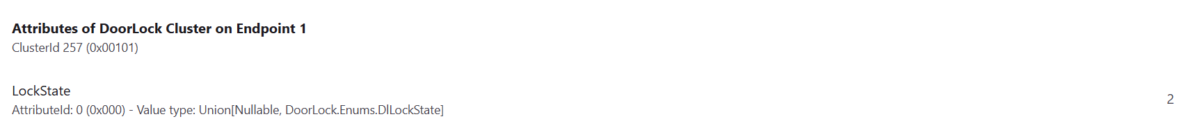

Just to confirm tho, the lock isn’t actually unlocked after 2 minutes ? Its just the g6 misreports its state ?
Yes the state just changes, not the lock
This changes to 2 (unlocked) from 1 (locked) after 1-2 mins:

Let us know if your lock entity goes to unlocked after a minute or so
It took 4 minutes, but it just silently changed the lock state entity without actually locking or unlock the lock. So yeah, seems I get the same issue.
