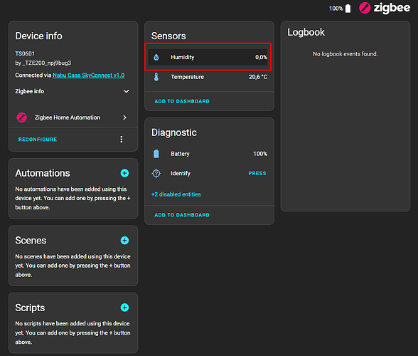

Recently I bought some Zigbee plant sensors and I added these to Home Assistant, but not all sensors that have been found by ZHA are correct. The humidity sensor should be a soil sensor and the value of this sensor isn’t picked up. Is there a way to get this sensor functioning the way it should?
Yes, i had the same problem, it seems this device is quite new and would need a custom quirk to connect, that is not written yet. I swapped out ZHA for Zigbee2MQTT, which makes this device work for me.
hello @wallie018, welcome to the forum :slight_smile: and thanks for sharing you’re solution. I already have quite some devices configured through ZHA so switching to Zigbee2MQTT is a big step. Hopefully a custom quirk will become available eventually.

I can confirm that humidity is the soil humidity.
so it does not really need any manual quirks. Just rename the sensor in HA.
It is zero as long as it is measuring empty air. if you touch it with your finger or put it into actual soil, the value goes up.
