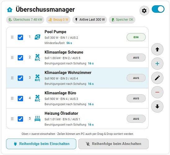

When enough surplus is available, consumers are switched on one after another according to their configured priority. When the surplus disappears again, they are switched off again.
One important point for me was having separate priorities for switching on and switching off.
For example, I may want my pool pump to start first when surplus becomes available, but an electric radiator should be the first device to be switched off again when available power drops.
So each consumer has its own switch-on and switch-off priority.

The order can be changed directly in the dashboard card. On desktop, drag and drop is also supported.

The integration comes with its own Lovelace card.
It shows the current surplus, grid import, active load, battery status and the configured consumers. Consumers can be added, edited, removed and reordered directly from the card.
Most of the important settings are also available through the settings dialog, including the reserve, grid sensor, battery guards, operating mode and diagnostics.
The diagnostics section shows values such as current grid power, surplus, import, reserve, controller status and the next consumer that could be activated. This has been very useful while testing the control logic.

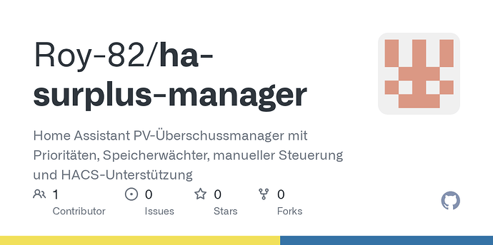

The repository is here:
Installation is currently done through HACS as a custom repository.
Add:
as an Integration in HACS.
After installation and a Home Assistant restart, the integration can be added through Devices & Services.
The dashboard card is included with the integration itself.
