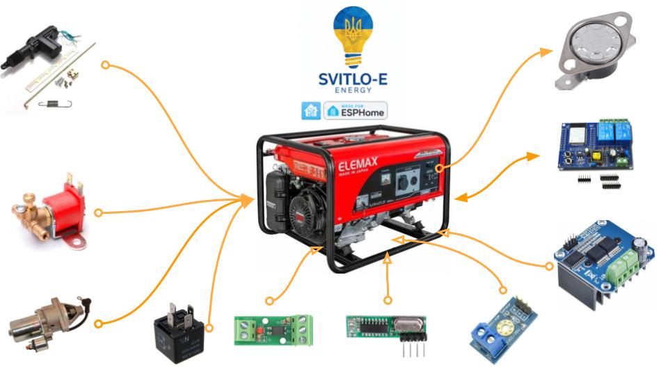

:battery: SVITLO-E: Intelligent Generator Control System
A professional (almost) automation and monitoring system for a gasoline generator based on ESPHome. Provides safe start-up, lubrication parameter control, hour meter and remote control.
:tv: Short video
Important
ATTENTION: The system works only when the physical ignition key is in the β€œON” position. Since it is impossible to track the key position (β€œOFF”/β€œON”) using standard means, full automation will require replacing the ignition switch with another one. All components (sensors) are connected in parallel, except for the damper actuator and temperature sensor. Standard control systems are not disrupted: even if SVITLO-E fails, it will be available!

ATTENTION: Connect the sensor to the additional 12V output on the generator! The 12V output is a low-voltage DC line built into most modern gasoline generators. The main functions of the 12V output on a gasoline generator are - Charging car batteries - but!!! The output has a very strong pulsating current! Do not connect just any battery for charging!!
Important
Life hack: A fuel solenoid valve is connected to the 12V output (see diagram)! This helps to automatically supply fuel to the carburetor and the fuel tap is always in the open position!
