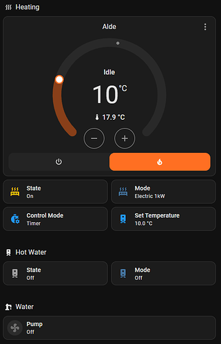

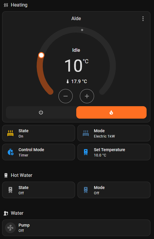

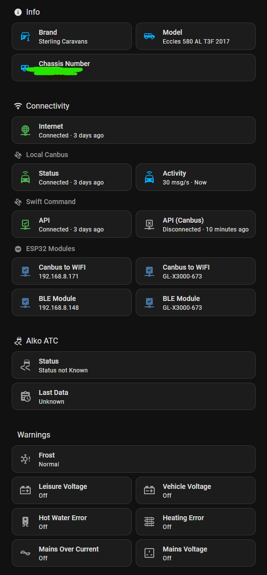

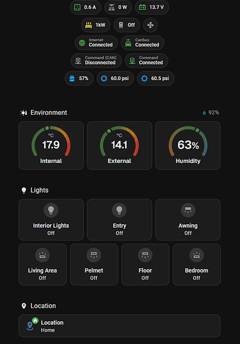

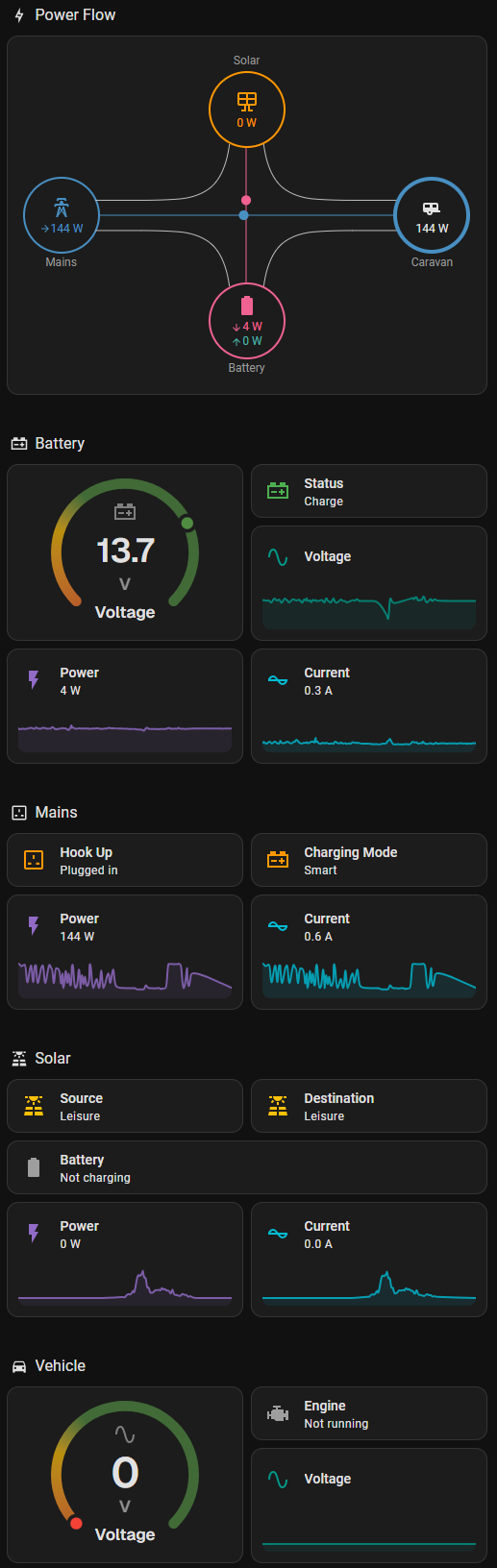

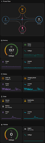

I went a bit further and did a near complete custom component. Still got heating and hot water control to sort. Don’t flood the API as you will get rejections and not be able to connect for a while

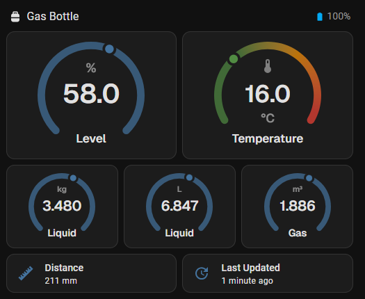

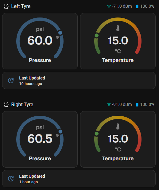

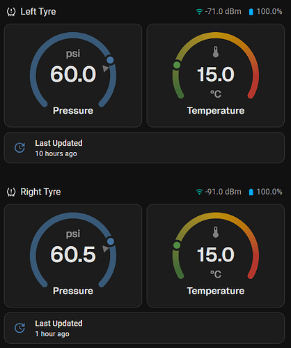

I also have directly connected an ESP32 and a canbus adapter to the caravan canbus and have near complete local control and monitoring. Took a lot of trial and error to decode the canbus signals. I’ve also got home assistant installed in the caravan with some BLE tyre sensors and a BLE gas tank sensor
