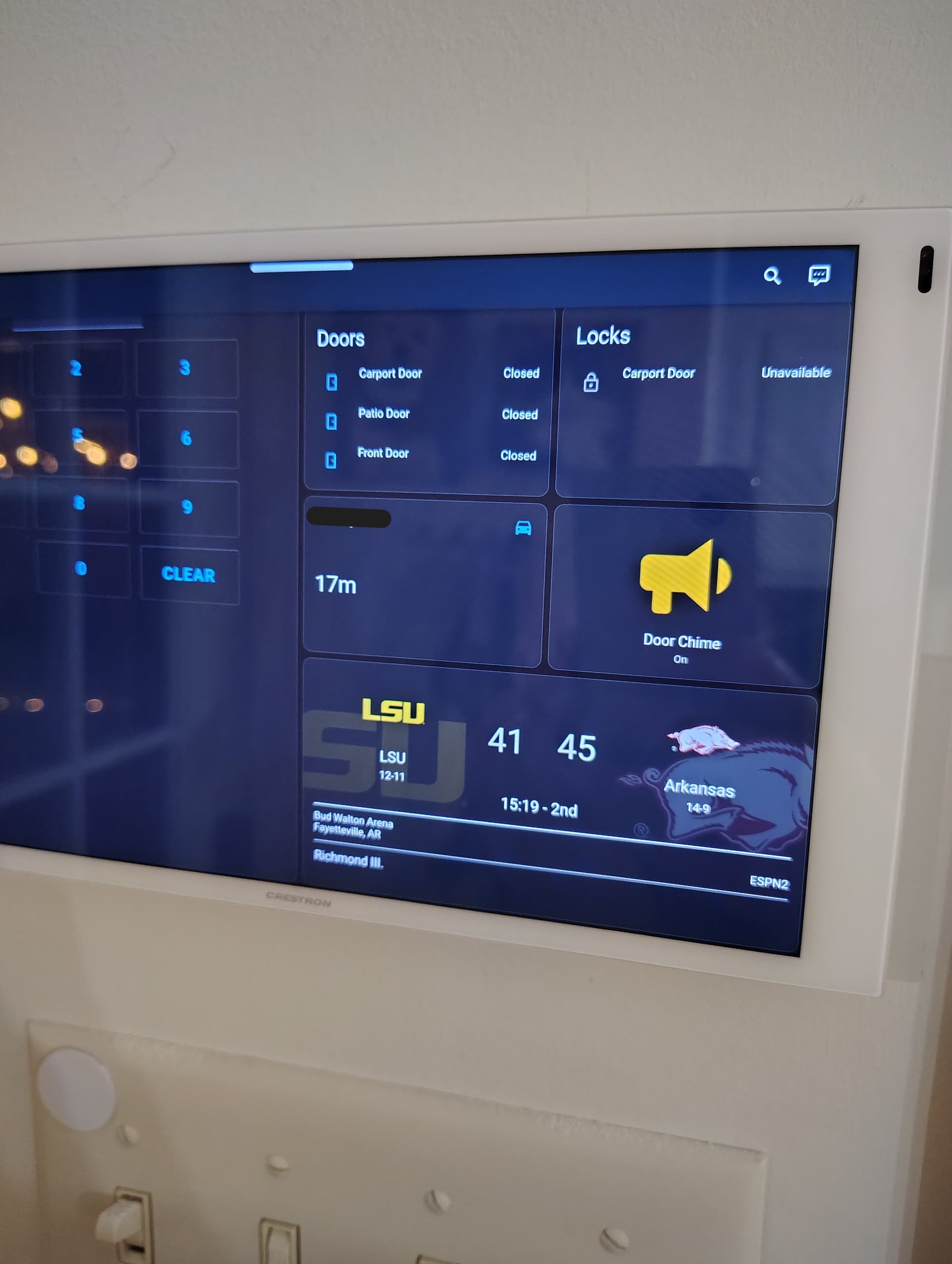

I have two Crestron touch panels that I am using in my home that tie back to HA. One my TSW-1070 panel, swipe card works perfectly (tried to insert pic, but I’m limited to one embedded image per post).

Here’s the working card on my TSW-1070 (bottom right), it rotates through different sporting events
