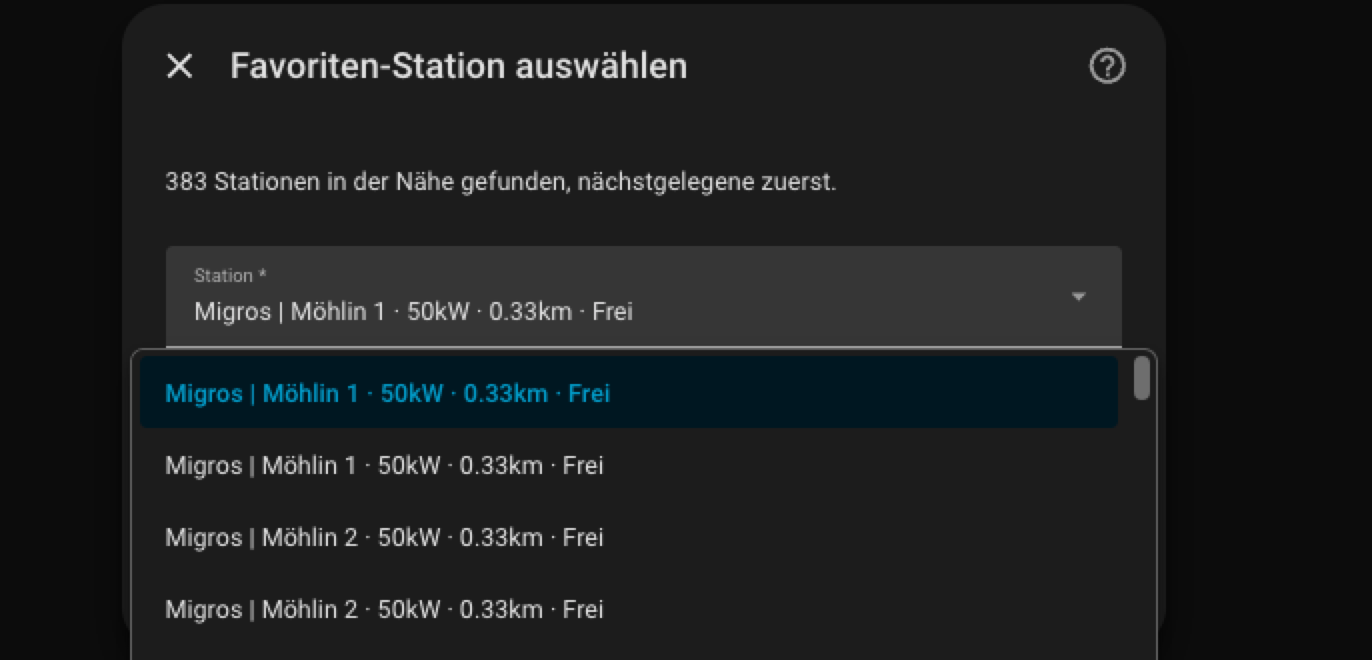

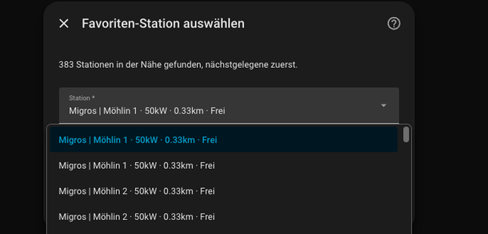

For my use case, im combining the chargers into “one station”, for example:
You have four single chargers - so if I want to have all of them within HA, i need to add them four times. My approach was to use the Station-ID “CHMIGP*1797” and all stations will be included - like on ich-tanke-strom.ch
for my use case, the benefit is, i have indication of the total amount of available and used chargers.
But I guess its kind of en “chicken or egg problem”.

While I was at it, I also implemented what you suggested: you can now favorite an entire charging site instead of just a single connector. When searching near a location, the picker now also lists whole sites (marked with a :round_pushpin: icon and the number of charge points) alongside individual connectors — picking one creates a device with a summary sensor plus status/power/plug type/operator sensors for every connector at that site.

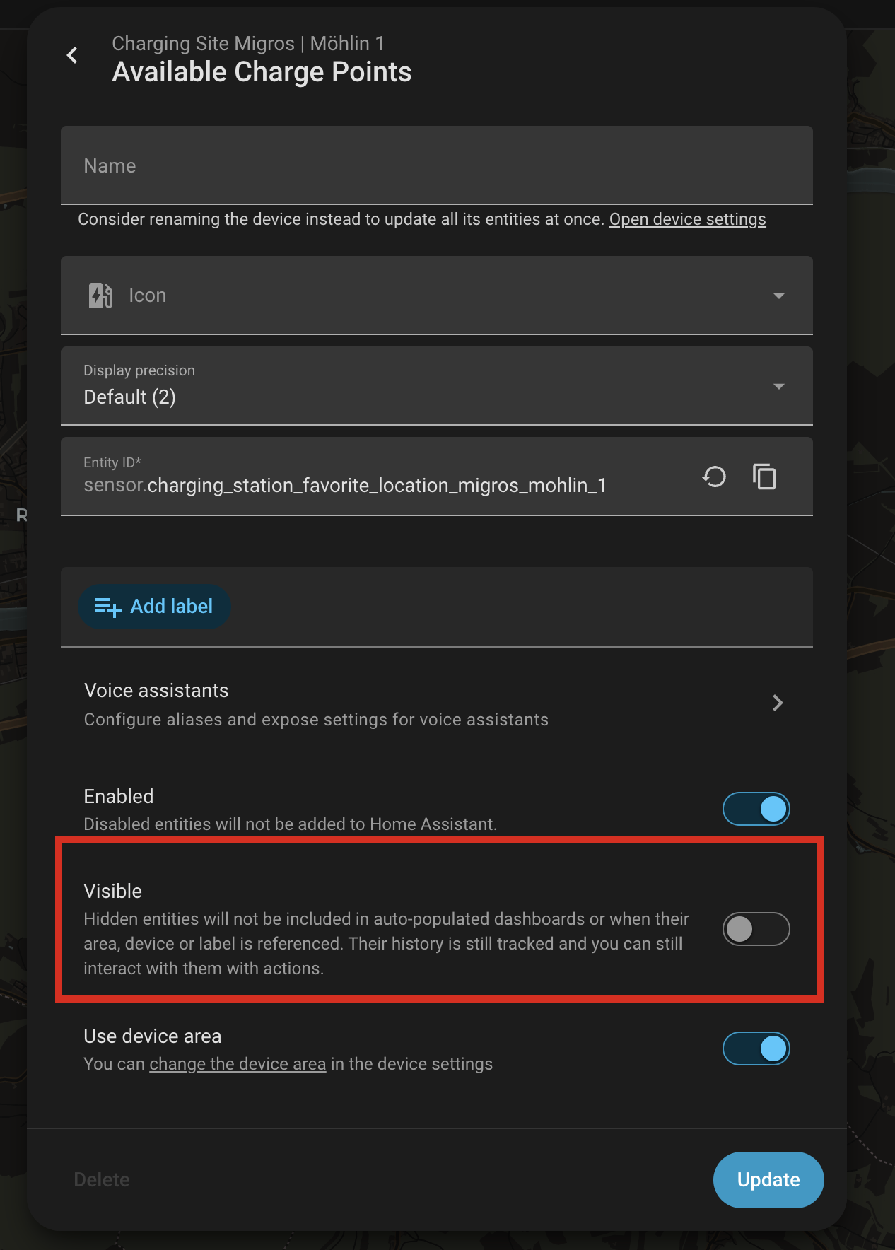

I had to hide the charging station, when I favourited it, it still was visible on the map:
=> no big deal at all

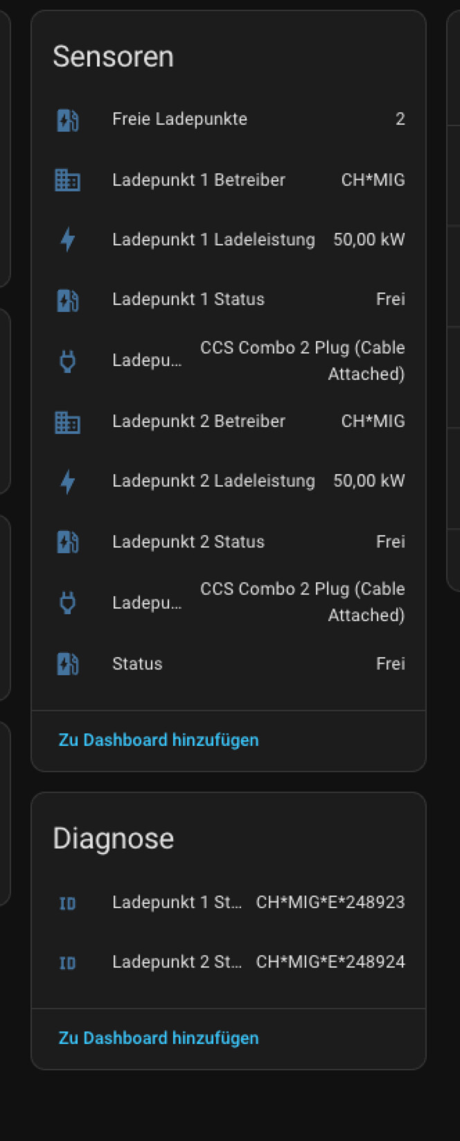

regarding merging the station:
i’ve double checked the Migrol one in Möhlin, there are two chargers with two cables each. The component detects two single stations with two cables. For me as a human its just one station/location - so personally, it would help for me to have it as a single single entity with a total of four chargers.

Merged charging sites (v1.2.1): You were right about the Migrol site in Möhlin. The source data reports each pole as its own station there (that’s also why Tesla superchargers showed up as 10 separate one-connector “stations”). Stations sharing the same operator and address are now merged into a single location — your Möhlin site appears as one location with 4 charge points and can be favorited as a whole. One note: existing favorites keep working unchanged, so to get the merged view, remove the two old favorites and re-add the site as a single location favorite.

Map marker after favoriting: That one’s expected behavior for now — the marker belongs to the radius overview, and the map card reads directly from the state machine, so the entity’s “Visible” toggle doesn’t affect it. Hiding it the way you did is the right workaround; a cleaner solution is on the list.

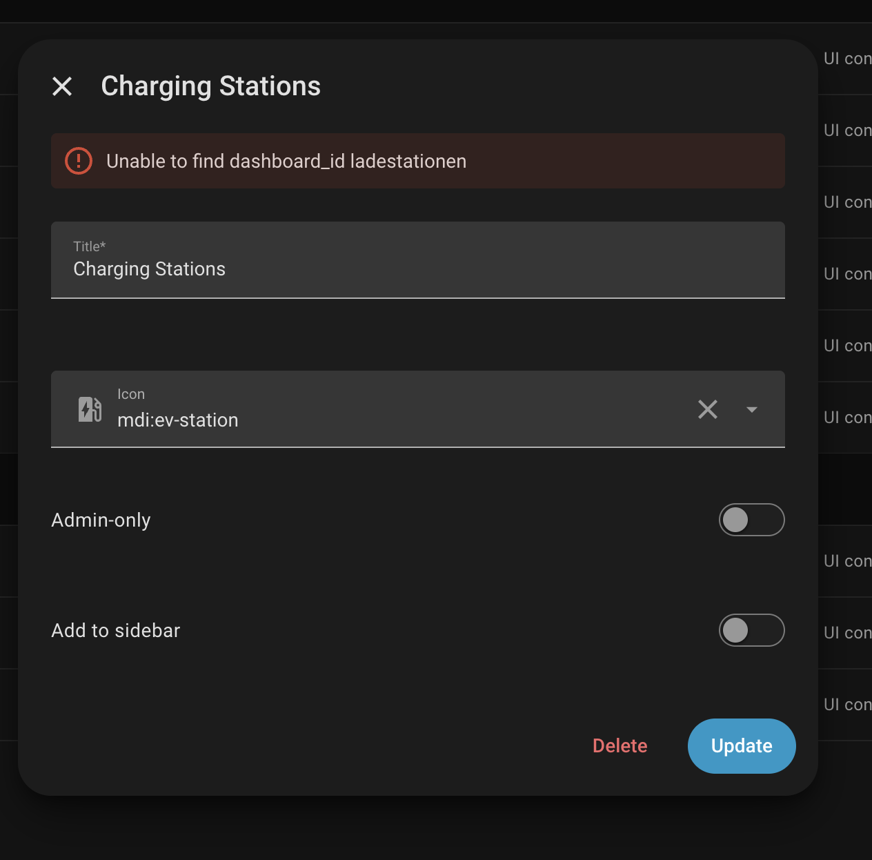

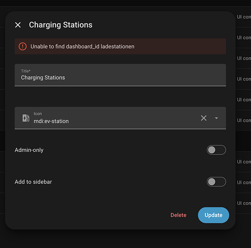

Since I don’t need the map, i wanted to delete the extra dashboard but I couldn’t:
Had to restart the Home Assistant Container, then I was able to. Looking forward how it goes for the updates. => no big deal at all :slight_smile:

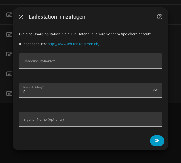

Adding a station by ID
This is just a wellbeing/cosmetic feature. If you want to add a station that is a bit further away, you need to find its coordinates on Google Maps and paste them into the search dialogue. Since these stations have unique IDs, you might want to copy and paste the ID into the configuration flow.

Adding by ID: The ID field in the favorite setup now accepts a whole-site ChargingStationId in addition to a single charge point’s EvseID — so you can add an entire site directly without searching by location.
Dashboard deletion: That was indeed a bug — the auto-created dashboard came back after a restart if you had deleted it. Fixed: it’s now created only once, deleting it sticks. The sidebar entry itself needs one restart to disappear; that part is a Home Assistant limitation for panels registered by integrations.

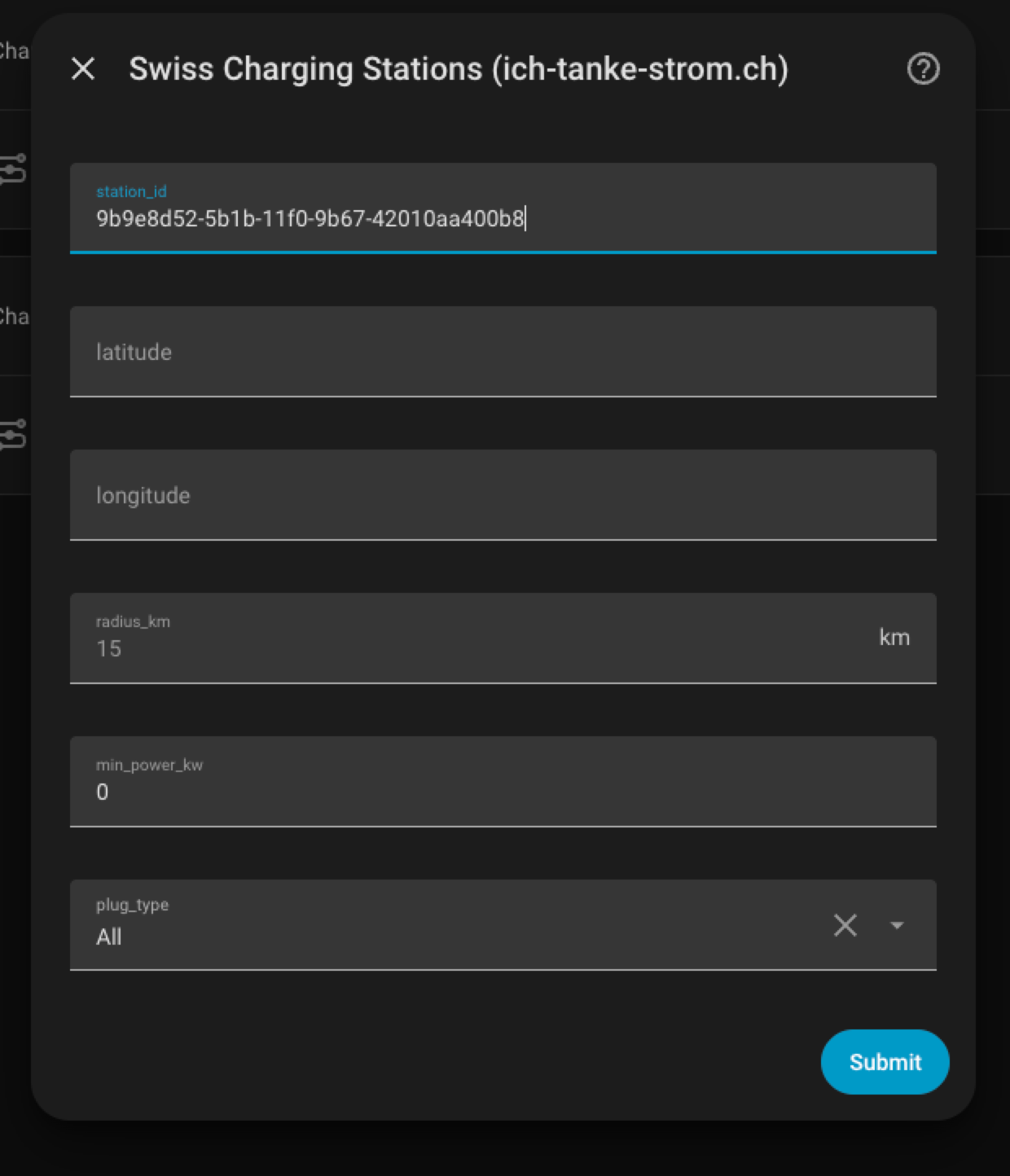

I’ve tested version 1.5 and i really love the add version by using the GUID/ID of the station.

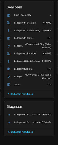

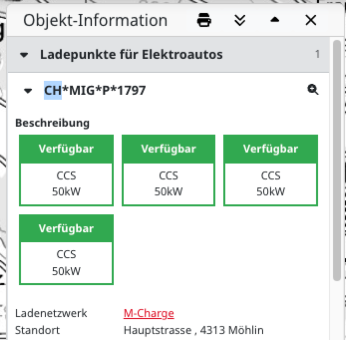

I might discovered a little bug:
adding a charger station by the GUID works very welle (example: e3688f8e-478d-11f1-b8c6-42010aa40fdd)
When using the “Displayname” it does not load all the chargers, i’ve double checked there are no filters for sockets in the list. A few test examples:
CH*MIG*P*1797 > ich-tanke-strom: 4x CCS and HA shows only two
Same behaviour with:
CH*POW*E88340 > 3 on web site > 1 in HA
CH*ECUE3AWUCZHP3MX75C5GC2Q74CG5GZ > 8 on web site > 1 in HA
It looks like it drills down to the first available data set.

Thanks Marco, great find — and your GUID observation pointed straight at the root cause. :+1:
Just released v1.6.1 which fixes exactly this.

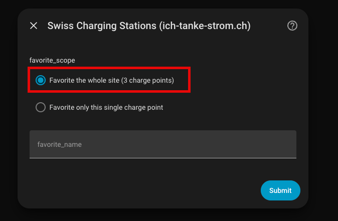

What was going on: the source data only has two ID levels (EvseID = one charge point, ChargingStationId = one “station”), but what a “station” covers depends on the operator: Lidl/GOFAST etc. use one GUID for the whol
e site (that’s why your GUID worked), Migros gives each pole its own ID (CH*MIG*P*1797 covers only 2 of the 4 chargers at that address), and PowerUp/the aggregators use one ID per cable (that’s your 1-of-3 and 1-of-8 ca
ses). The location picker has merged those by operator+address since v1.2.1 — but the add-by-ID path skipped that merge entirely. My bad.
In v1.6.1:
  • Any ID you enter is now resolved to the full physical site (same operator+address merge as the picker). CH*MIG*P*1797 → 4 chargers, CH*POW*E88340 → 3, your CH*ECUE... → all 8.
  • If you enter a single charge point’s EvseID and the site has more, you now get a choice: pin just that charge point, or the whole site (default).
  • New confirmation step shows what was resolved and lets you set a custom name (the ID path never offered that before).
  • And you were right about the opening hours too — the source does have an OpeningTimes schedule for some operators (it’s just empty for 24h sites, which is why I missed it). Site status now evaluates it: a site outside its opening hours shows as “Closed” even if the operator still reports the connectors as “Available”, and today’s opening hours are shown on the card below the address and on the dashboard card.
Update via HACS and restart. Thanks again for the detailed report with the exact IDs — that made it easy to reproduce against the live data.

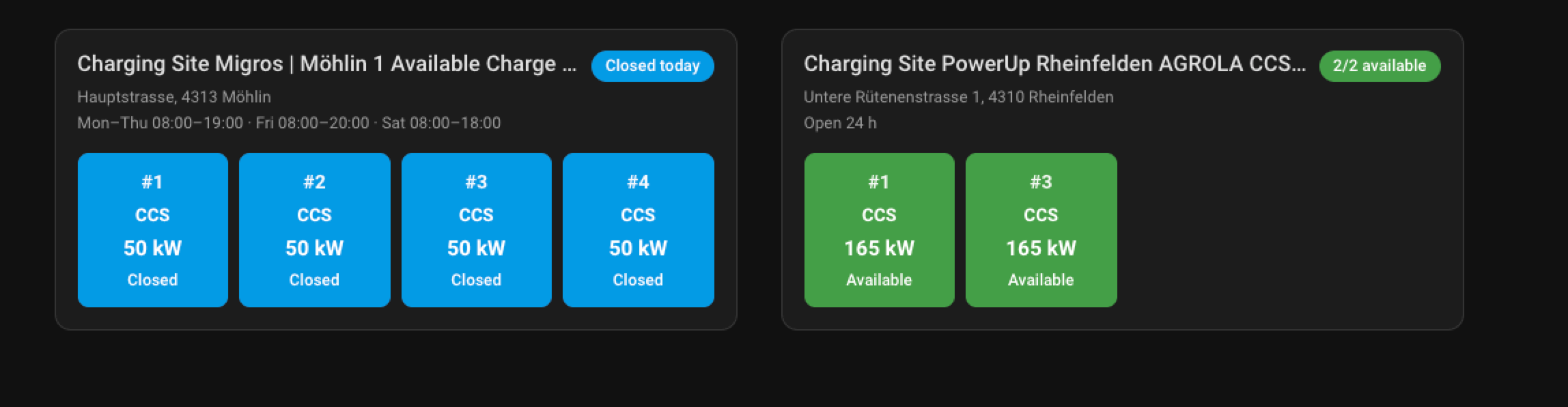

Updated to version 1.6.1 and it works like a charm. One last thing i
recognized:

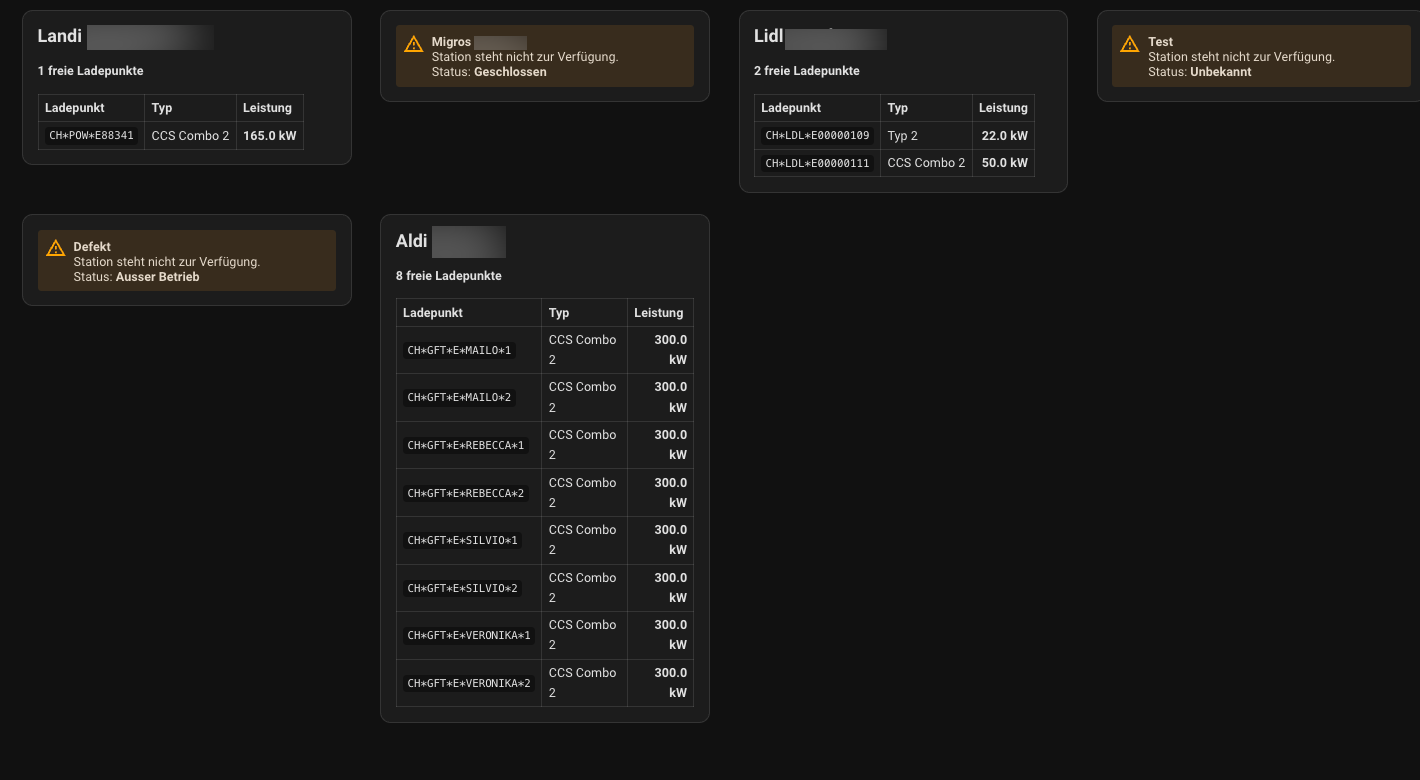

The station is closed but the chargers are still available. Thats technically, from an API perspective, correct but you can’t charge right now. I would suggest to set them to “closed” too - just in case you’re just looking at the green tiles.

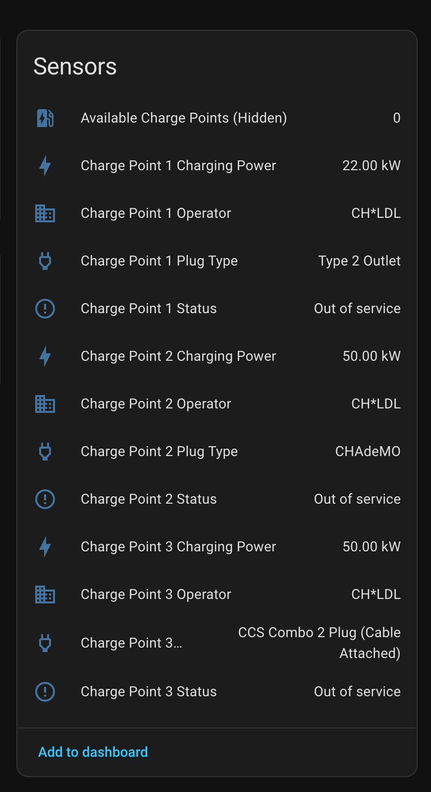

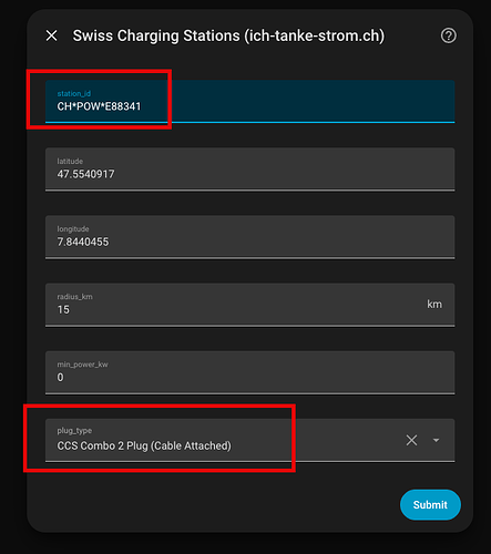

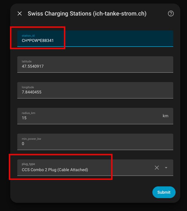

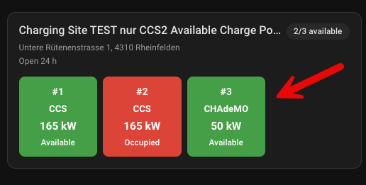

EDIT: Found another possible bug - filtering of plug types:
Station:
CH*POW*E88341
Adding the station by ID:
The station has three plugs, two of them are CCS 2
The component counts the AdeMO in:
And the card shows it as well:
Good points — the first one is released in v1.6.4: while a site is closed, the tiles no longer stay green. They turn blue with “Closed” — blue as its own color next to green (available), red (occupied), gray (out of service) and yellow (unknown status), so a closed site doesn’t look broken. The badge also distinguishes a full-day closure (“Closed today”, e.g. Sundays) from being outside today’s hours (“Closed”), the availability badge is now green/red depending on whether something is still free, and the card shows the site’s weekly opening schedule below the address (“Mon–Fri 08:00–20:00 · Sat 07:30–18:00”).
The sensors themselves keep reporting the raw operator status (“Available”), so automations still see exactly what the API says — plus site_status and closed_all_day_today attributes if you want to act on the derived state.
On the plug types at CHPOWE88341: I checked the live source data — that site really does have three charge points: 2× CCS Combo 2 at 165 kW (E88339, E88341) and 1× CHAdeMO at 50 kW (E88340, its station name literally contains “CHAdeMO”). So the card showing a CHAdeMO tile is the source data, not a counting bug.
What I suspect happened: the plug-type filter in the favorite dialog only applies to the search by location path — it’s ignored when you enter an ID directly (the field labels say “only used if the ID is empty”). And that’s intentional: I think it’s more useful for a site favorite to always show the complete site, even when a filter was set during the search. The filter is there to help you find a suitable site; the favorite then mirrors the physical reality — hiding connectors would make the counts and the site status misleading (a “1/2 available” that is actually a 1/3 site). Since every tile shows its own plug type, you can spot your CCS chargers at a glance anyway.
I need to think about it—or what do you think makes more sense for the user?
Schöne Sunntig Tinu
your use case makes sense, so v1.6.5 adds it where it belongs — on the card: the visual editor now has a “visible plug types” multi-select. Pick CCS only and the CHAdeMO tile disappears, with the availability badge counting just the visible connectors (“1/2 available”). Purely visual — the favorite and all sensors keep covering the whole site. v1.6.5 also fixes a few things you may have run into: the auto-generated cards now work with the visual editor, your card edits survive restarts, tile order now matches the “Charge Point 1/2/3” sections, and deleted favorites can no longer leave their card behind.
