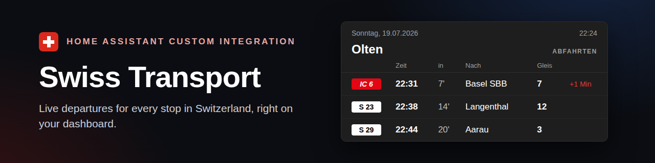

I built a custom integration that brings Swiss public transport right into Home Assistant – the live departure board of any stop, and your personal saved connections (from → to). Data comes from the free transport.opendata.ch timetable API (backed by search.ch) – no account or API key required.
There’s already the official swiss_public_transport core integration, but it only does A→B connections. This one adds the thing I was missing: a proper station departure board with its own good-looking Lovelace card, plus an auto-generated dashboard.
What it does
  • Departure boards – the live Abfahrtstafel of any station: train, tram, bus, ship or cableway, with real-time delays, platform and destination.
  • Connections – save a route (e.g. your daily commute Olten → Zürich HB) and see the next departures with time, platform, duration and number of transfers.

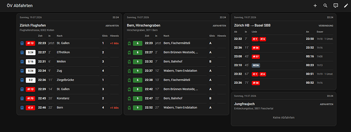

  • Bundled Lovelace cards – two self-registering cards (no manual resource setup), both with a visual editor. Laid out like a real departure board: symbol · time · countdown · destination · platform · info, with colored line badges and a live date/time bar. The platform column is hidden for bus/tram stops.
  • Auto dashboard – on first setup it creates an “ÖV Abfahrten / Departures” dashboard and adds a card for every station/route you configure (and cleans up when you remove one).
  • Multilingual – German, English, French and Italian, following your HA language.

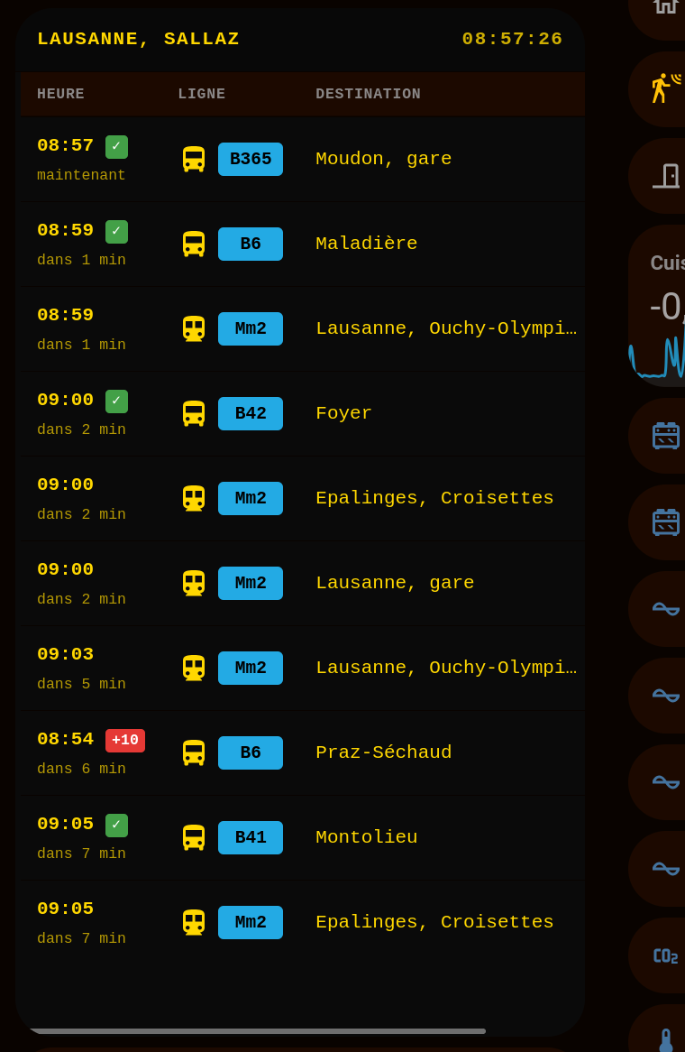

Thanks a lot for the share :wink: For info there is an other integration that works great and gives also departure board: https://www.openpublictransport.net/ and result in my HA:

Small update for everyone: v1.2.0 is out with timetable browsing – every board can now be switched from the live view to any date and time: pick a time and see departures from then, or flip to an arrivals mode (“which trains arrive before my meeting?”). A new selector bar card (Live / Departure / Arrival + date-time picker) is added to the auto dashboard and switches all cards at once. Connection cards now also show platforms and transfer stations per leg.
